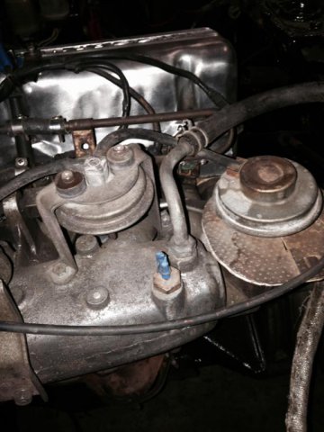

280z manifold help
norbert
Ive looked through 2 manuals and can't find anything, hopefully some one can help me out..
Between the bpt and erg valve, theres a little nipple for a hose, unfortunately i didn't label it, or the hose when i took the engine out, now i can't figure out what am i suppose to hook up to it. any help would be great, (its the one with the blue tape on it)post-30797-0-95312500-1394770824_thumb.jpg
It's for the vacuum tank that runs the valves in the heating system.  A small diameter hose would run from there back to the firewall, over to the battery area and on to the off-white, ~quart-sized, plastic tank on the right fenderwell.
