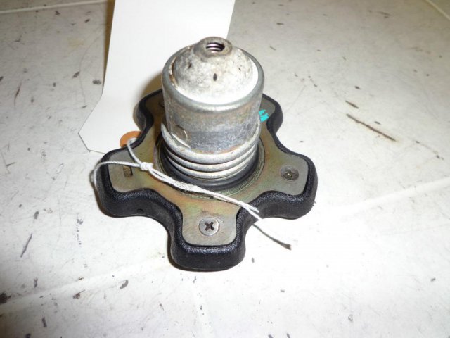

Thank you for your quick response. Here are a couple of pictures of my gas cap. I don't see what you are referring to as far as a spring loaded valve that can be picked open with my fingernail.
That's different than a 280Z's.  But that's what "vacuum relief valve" means on the diagram I attached.

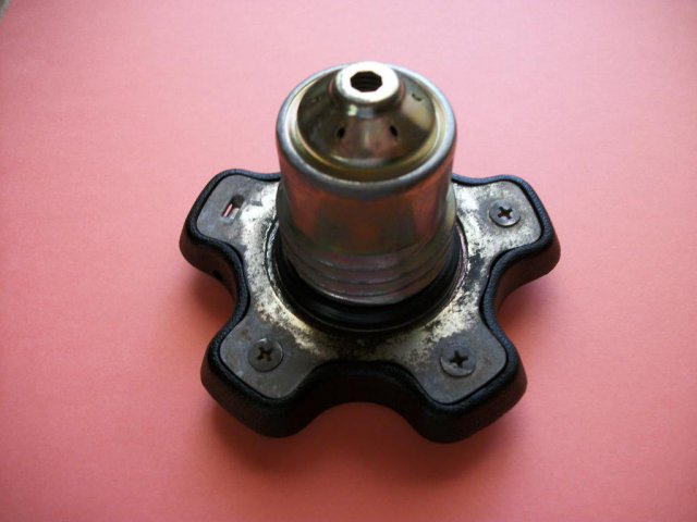

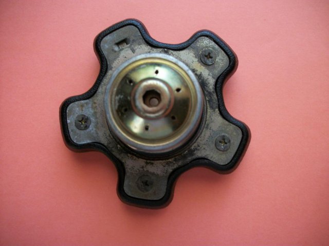

Here are a couple of pictures of a used cap off ebay for a 280zx Turbo. Looks just like mine. I'm going to take your first diagram with the vac hose routings and trace mine and see if I can find a problem before I purchase a new cap.

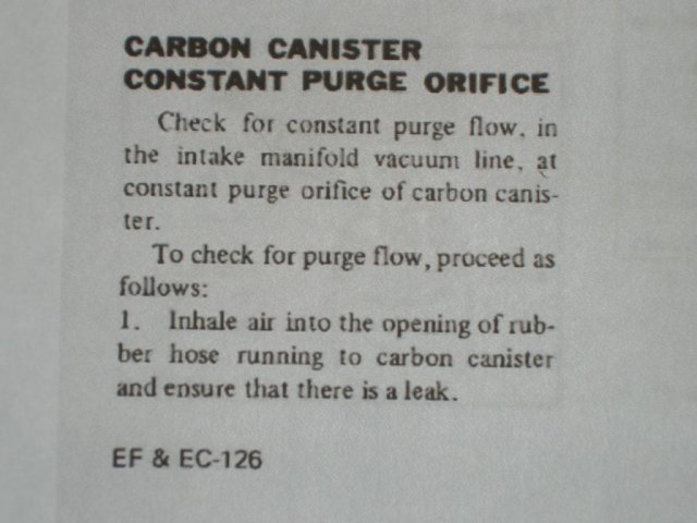

B.  Carbon Canister Constant Purge Orifice does not leak as it should. It is supposed to leak!!!!

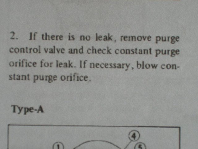

I used short spurts of 120 p.s.i. on the hose to free up the orifice (stated on page 126). Didn't work!!!
It says to remove Purge control Valve and check Constant Purge Orifice for leak.  How do I do that????
I don't see any way to separate to remove the cover.
I have included pictures from the FSM (pages 125-126).
