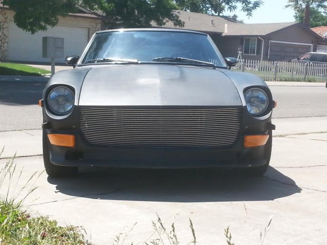

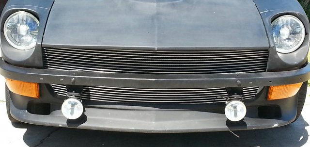

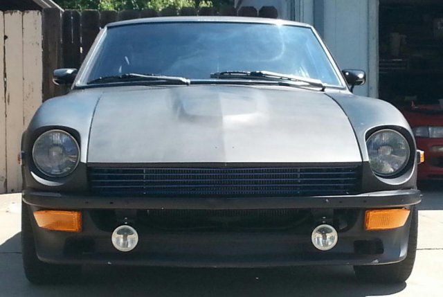

88dangerdan Posted June 3, 2014 Share Posted June 3, 2014 It only took an hour to get it to look like this from this Then it took about another hour to get it to look like this The grille is off of a '08 GMC 1500 and only cost me $20 So you got two choices, but if you choose second one can't go back without having two of these Daniel Quote Link to comment Share on other sites More sharing options...

Domzs Posted June 3, 2014 Share Posted June 3, 2014 Looks good with the bumper . Quote Link to comment Share on other sites More sharing options...
88dangerdan Posted June 3, 2014 Author Share Posted June 3, 2014 Yeah I like it better with the bumper. Thanks Dom Daniel Quote Link to comment Share on other sites More sharing options...

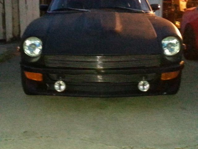

socorob Posted June 3, 2014 Share Posted June 3, 2014 Can you post a brighter clearer picture with the bumper mounted? Quote Link to comment Share on other sites More sharing options...

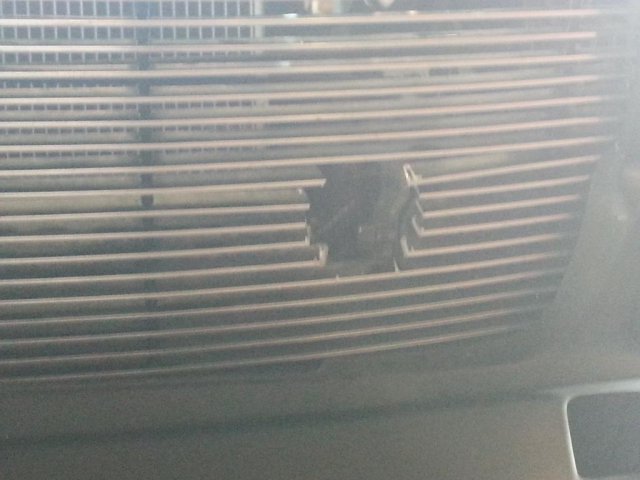

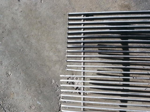

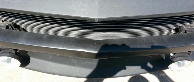

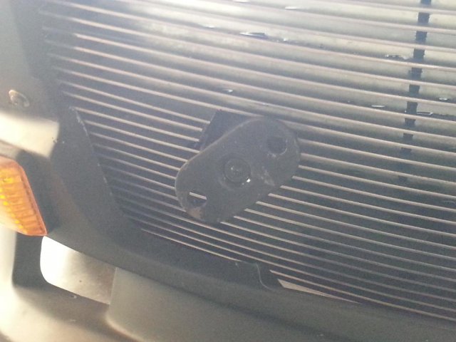

88dangerdan Posted June 3, 2014 Author Share Posted June 3, 2014 The '08 GMC billet grille is fastened with 5 screws right over the OEM grille that has the GMC logo it's part of the upgrade package and considered OEM not that it matters for what I did. The cuts I had to make were 1" inward on the top on both sides, and 13 slats down. Then found center where my bumper struts lined up and cut 2" diameter hole. I had the struts off so I could come through at an angle so as to keep the hole smaller. Then made a couple of L brackets that screwed in the same hole the original grille did. Quote Link to comment Share on other sites More sharing options...

socorob Posted June 3, 2014 Share Posted June 3, 2014 Also is it not mounted straight? One side looks higher than the other. Quote Link to comment Share on other sites More sharing options...
88dangerdan Posted June 4, 2014 Author Share Posted June 4, 2014 The way it was explained to me was that it came off the lot with it. It was offered as part of a upgrade package. And the way it was fastened I could see that being possible. And yes, good eye it is a little crooked I was hoping no one would catch that but I should have known better. I have to go back and adjust the one side. The earlier picture that was taken last night shows it straight. I think I make a little stiffer L brackets Quote Link to comment Share on other sites More sharing options...
