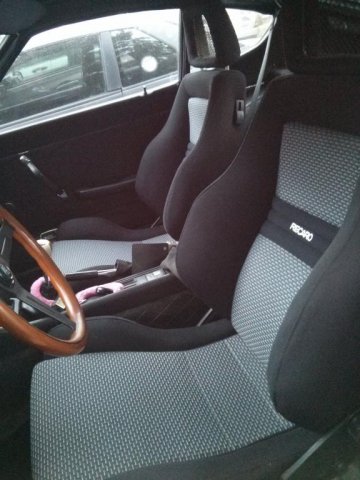

I got the driver side installed Wednesday evening. I did notice that with the driver side there is a hump in the trans tunnel that the reclining knob will not clear. I had to remove the inside knob, but it's fine because the other side knob is still present and it works just fine. Sitting in it with a steering wheel as reference, I had a better feel for it all. It sits a little bit higher compared to the fake-aro seat, but not enough to say that it's "too high", at least not for me. Over all I like it!
The seats with the center console as reference, hopefully that will help show how high the seat sits.

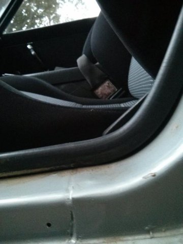

From a lower perspective to compare the seat to the door jams. (pls excuse the surface crud)
