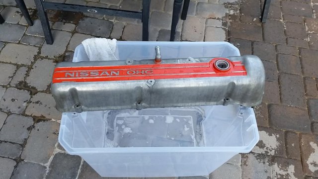

Painted my valve cover, pics inside
Before and after.

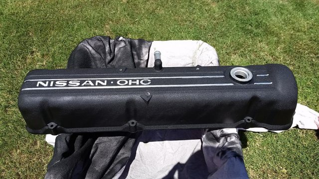

Prep work included spraying with aircraft paint remover, sanding and polishing the letters/lines, 3 coats of engine primer (VHT), and numerous coats of VHT wrinkle black paint.
Before:
After:
