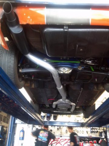

ktm Posted July 21, 2014 Share Posted July 21, 2014 Getting the JCI headers to make the 90 degree bend was definitely tricky-I think you made a good choice. And I concur on your plan to cersmic coat-it just makes for such a clean engine bay. I did my engine swap a couple years ago and it still looks like i just did it. I have v-banded my exhaust and I love it. I used the JTR headers, but basically followed your plan, but I went single from the y-pipe back. For what it is worth, dual 2.5" to single 3" made 400hp/435tq on my bone stock LS2 at the rear wheels. Get the exhaust to fit well and be easy to service, but don't spend too much energy on it looking for a lot of power. My setup is the same. JTR headers to a single 3-in. after the y-pipe. I love the shot below. Reminds me of a Matchbox car. Quote Link to comment Share on other sites More sharing options...

vdubn Posted July 22, 2014 Author Share Posted July 22, 2014 My setup is the same. JTR headers to a single 3-in. after the y-pipe. I love the shot below. Reminds me of a Matchbox car. Which tank are you using in that picture? It looks like its positioned over to the pass side of the car. My plan is to run the Camaro tank centered, so I am hoping that I'll have room for dual pipes. Quote Link to comment Share on other sites More sharing options...

ktm Posted July 23, 2014 Share Posted July 23, 2014 Which tank are you using in that picture? It looks like its positioned over to the pass side of the car. My plan is to run the Camaro tank centered, so I am hoping that I'll have room for dual pipes. I am using a 240z tank that I had modified. Quote Link to comment Share on other sites More sharing options...

Litman Posted August 5, 2014 Share Posted August 5, 2014 Which tank are you using in that picture? It looks like its positioned over to the pass side of the car. My plan is to run the Camaro tank centered, so I am hoping that I'll have room for dual pipes. Dual pipes are easily achievable with the F-body fuel tank. I centered my tank then built the exhaust around it using 2 1/2" tubing and Magnaflow offset/offset oval mufflers with a 14" body. Quote Link to comment Share on other sites More sharing options...
