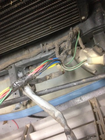

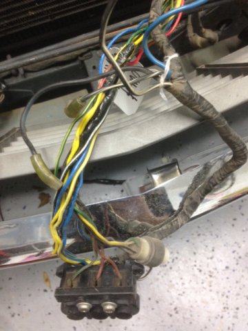

str8pipez Posted September 23, 2014 Share Posted September 23, 2014 (edited) I've been searching for a while in regard to wiring issues, but come up a bit short. I assume I know the answer but want to be sure. I pulled all the wiring from the drivers side (body harness) and want to clean up things like the coil wiring, distributor, a/c relays. etc. Stuff that obviously won't be used with the swap. Can I just cut and cap these instead of unwrapping the entire harness and removing them where they originate? I've attach pics of the wires in question. Edited September 23, 2014 by str8pipez Quote Link to comment Share on other sites More sharing options...
socorob Posted September 23, 2014 Share Posted September 23, 2014 A couple of the wires can be used for things that need switched 12v power, etc. and they are already fused. Quote Link to comment Share on other sites More sharing options...
str8pipez Posted September 23, 2014 Author Share Posted September 23, 2014 Good point, I just thought the same. On sorta the same topic, how about the shunt? Can't I get rid of that as well? I'm not using the Amp meter, voltage reg, or the stock alt. Quote Link to comment Share on other sites More sharing options...

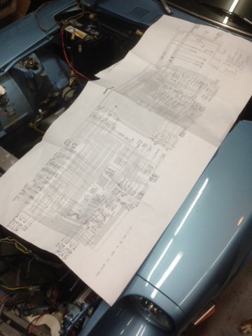

str8pipez Posted September 24, 2014 Author Share Posted September 24, 2014 (edited) This should help me trace the wires. The PROPER size wiring diagram! Edited September 24, 2014 by str8pipez Quote Link to comment Share on other sites More sharing options...
socorob Posted September 24, 2014 Share Posted September 24, 2014 When you have old eyes it's what you have to do. Quote Link to comment Share on other sites More sharing options...
str8pipez Posted September 24, 2014 Author Share Posted September 24, 2014 When you have old eyes it's what you have to do. LOVE IT! Glad I'm not the only one! Also my Black/white coil wire is only hot in the "ON" position. No worries though, the original is hot only during starting. Quote Link to comment Share on other sites More sharing options...
