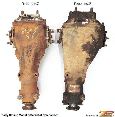

skerry Posted October 6, 2014 Share Posted October 6, 2014 The diff in my car says "T23" and "209" on it, I was under the impression that it was a stock R180 but I can't find any source to confirm this. Any other way I can do it? Thanks Stephen Quote Link to comment Share on other sites More sharing options...
Miles Posted October 6, 2014 Share Posted October 6, 2014 See picture. Quote Link to comment Share on other sites More sharing options...
skerry Posted October 6, 2014 Author Share Posted October 6, 2014 Thanks Miles, it's definitely the one on the left. Anyway to figure out the gearing without looking at the gears? Quote Link to comment Share on other sites More sharing options...
