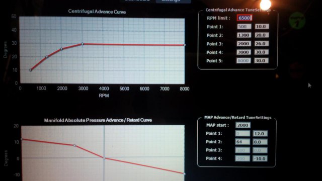

280zex Posted October 28, 2014 Share Posted October 28, 2014 I have received many pm's about what timing map I have programmed in my 123 ignition distributor so I'm posting a screen pic. Please note that my 280z is turbo charged and the map shows boost timing retard. Also know that even if you program your ignition system to my posted map, it may or may not work well with your system, as all Z engines are never the same. I set the rev limit to 6000 rpm's. I set the map input to start at 2000 rpm's. Quote Link to comment Share on other sites More sharing options...

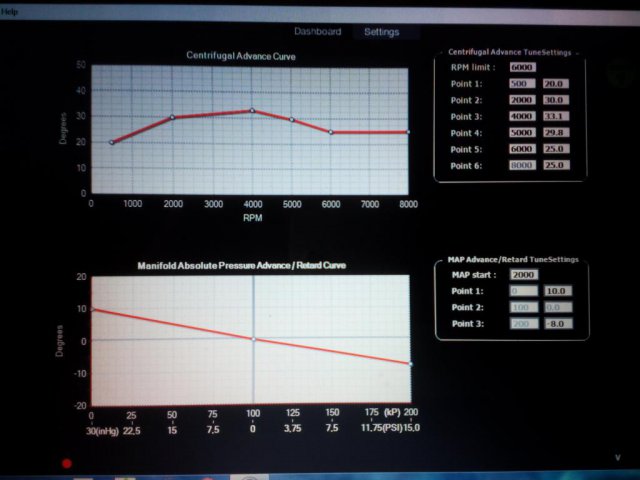

280zex Posted November 20, 2014 Author Share Posted November 20, 2014 I have been tuning my Z the last day or so and changed my timing map around a bit..... Quote Link to comment Share on other sites More sharing options...
