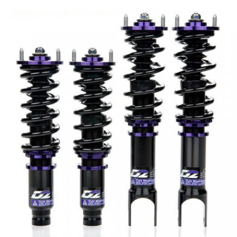

jfmb Posted January 2, 2015 Share Posted January 2, 2015 http://www.ebay.ca/itm/D2-Racing-RS-Coilovers-for-Nissan-240z-260z-280z-1970-1978-Suspension-/360892161456?pt=Motors_Car_Truck_Parts_Accessories&fits=Make%3ANissan%7CModel%3A280Z&hash=item5406d95db0&vxp=mtr Did anybody ever tried them ? Is it worth the $ Quote Link to comment Share on other sites More sharing options...
seattlejester Posted January 2, 2015 Share Posted January 2, 2015 (edited) There's a lot wrong with that. I wouldn't risk it. There is no mention of welding for installation, it says that it fits the 240-280z which unless it was a fully bolt in system with spindles provided would be difficult as the tubes are different diameter and height. No mention of spring rate or dampening and no pictures. There's quite a few vendors on here that have proven installs and products. BC Coilovers from JPN garage Stance Coilovers from Sakura garage AZC Coilovers from Arizona Z Car Megan coilovers from Mckinney Motorsports Tein coilovers from Tein GC bolt in coiler kit from Techno Toy Tuning Edited January 3, 2015 by seattlejester Quote Link to comment Share on other sites More sharing options...
