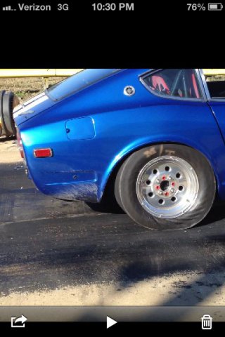

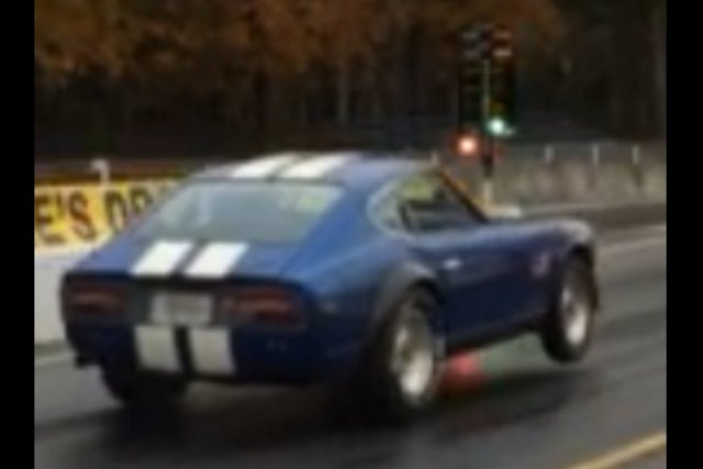

RebekahsZ Posted February 7, 2015 Share Posted February 7, 2015 (edited) I don't know where you are located where it is still warm enough to race but I'm jealous. The car wont squat if it doesnt hook. Hook then squat. My car doesnt squat at all in the burnout area. If you get the chance, get a buddy to video the car a bunch as it launches (cell phone works great). Paint a stripe on the front and rear tires with shoe polish so you can see when and how much it actually spins. Get one of the grand kids to help you slow down the video so you can actually study it. You will get conflicting advice, so use whatever works. I race with a guy with a stock fendered, stock suspension (soft) with 26x10 MT ET Drag slicks and a T350 and he doesn't spin. I talk with jnjdragracing who runs blown SBC and A/T (glide?) with 28x10 MT ET drags, stock suspension and hard foam bumpstops after an inch of suspension travel (so basically no suspension) and he doesn't spin and totes his front end all the way down the track. I think tires are gonna be your solution. Borrow a set of rims and see what it would take to run them. I have AZC disc kit and I have to run 1" spacer adapters to clear the calipers, but with flares fenders, who cares? They were like $44 from eBay. I inspect them regularly and the studs stay torqued and have never loosened up. Look at my YouTube channel (search RebekahsZ) and you can see some of my launch videos and learn what you can from them and laugh about the stupid ones. Track conditions can vary so much day to day. I don't have enough power to rest do the 28s justice-I e only run them at our stickiest track and I was dead-hooking and running slower than I did on 26s. I let my tires spin a little so I can just drop the clutch and forget about it. Too much tire spin=slow. Too little=slow. It's all about trying to find "just right" and that formula varies with the track and even the weather. Wish you lived next door and we'd share some tires, but there won't be any consistent racing here till May. You can't worry that much about the suspension behavior until you hook at least enough to move the suspension. Then come back to shocks and spring rates. Those things do matter but not at the point where you are now. Edited February 7, 2015 by RebekahsZ Quote Link to comment Share on other sites More sharing options...
