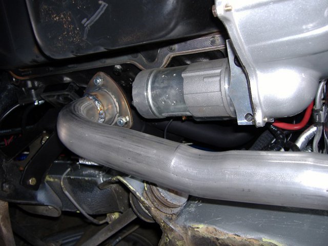

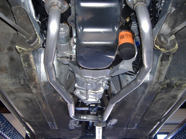

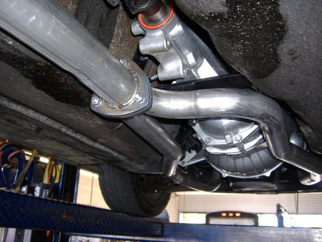

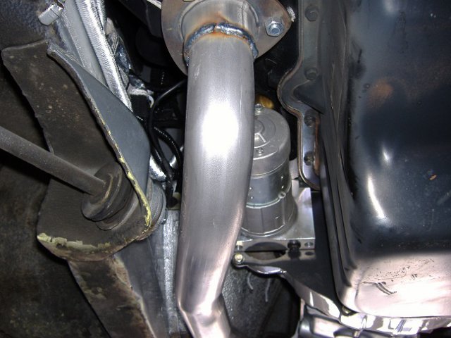

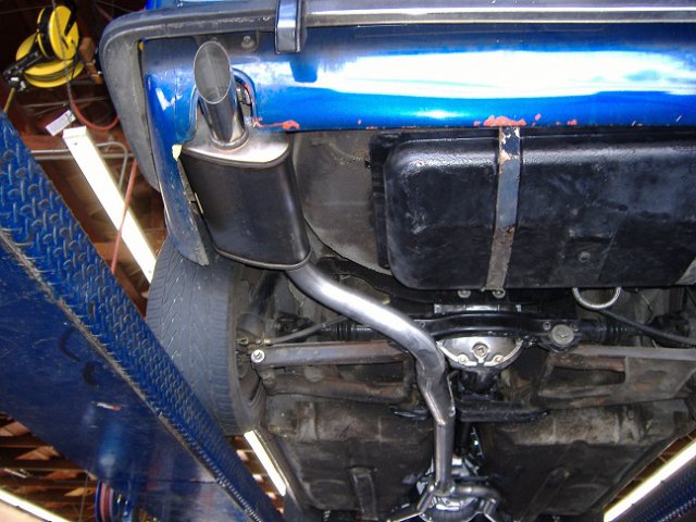

Here you go.
Note:
  • Access to oil filter and starter.
  • Flange at rear of transmission to allow removal of tail pipe for  access to the drive shaft, parking brake, differential and rear suspension etc.
