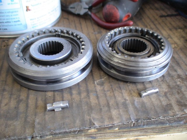

Solved:   The T5 4th gear synchonizer assembly hub keys broke and fell out.
The transmission shop I bought the rebuilt T5 from six years ago replaced the synchonizer hub and keys at no charge.
