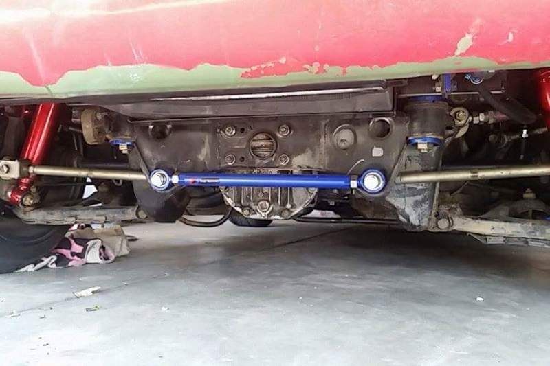

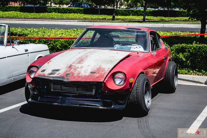

Rolling280z Posted May 18, 2015 Share Posted May 18, 2015 (edited) 1974 260z motor-2jzgte vvti Tran- z31 / stage 5 clutch Suspension - s13 rear subframe, s14 flca,knuckles,hub. S14 coils. Everything adjustable in the rear brakes- z32 all around, 30mm rotors,stainless steel lines Fuel system- fuel cell,aem 380 lph pump. Wheels- atara 15x10.5 -32 offset Tires- 225/50/15 http://rs124.pbsrc.com/albums/p37/rolly20061987p/Mobile%20Uploads/17613210160_1a01a5c34b_h.jpg~320x480 http://rs124.pbsrc.com/albums/p37/rolly20061987p/Mobile%20Uploads/20150504_191350.jpg~320x480 http://rs124.pbsrc.com/albums/p37/rolly20061987p/Mobile%20Uploads/20150421_205907.jpg~320x480 http://rs124.pbsrc.com/albums/p37/rolly20061987p/Mobile%20Uploads/20150224_183024.jpg~320x480 http://rs124.pbsrc.com/albums/p37/rolly20061987p/Mobile%20Uploads/20150317_192931.jpg~320x480 http://rs124.pbsrc.com/albums/p37/rolly20061987p/Mobile%20Uploads/20150317_193040.jpg~320x480http://rs124.pbsrc.com/albums/p37/rolly20061987p/Mobile%20Uploads/IMG_20150323_114800.jpg~320x480http://rs124.pbsrc.com/albums/p37/rolly20061987p/Mobile%20Uploads/IMG_20150329_222620.jpg~320x480 .. . It was a ton of work but well worth the effort. Edited June 2, 2015 by Rolling280z Quote Link to comment Share on other sites More sharing options...
stupid_fast Posted May 18, 2015 Share Posted May 18, 2015 (edited) Very nice, Alex was just talking to me about this build. What are your plans with the car? Track build or just show car? Edited May 18, 2015 by stupid_fast Quote Link to comment Share on other sites More sharing options...
Rolling280z Posted May 18, 2015 Author Share Posted May 18, 2015 Well... track/daily it. I wanted this car to be driven not garage stored. Alex, he has a crazy build going on too. I want to see it when he is done. Quote Link to comment Share on other sites More sharing options...

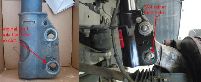

TUME Posted June 9, 2015 Share Posted June 9, 2015 Why are you wanting positive camber, or just misunderstandig. I would stay on negative side, not that much, though... Spacer between knucle and coilover bottom mount only gives you space between tire and coilover. What matter is pivot points i.e strut upper mount and balljoint. If you are only on reduce camber, why not adjust on coilover bottom mount and knucle bolt. Something like this Or just shorten LCA, I assume you have camber adjusted plates on strut upper mount. Quote Link to comment Share on other sites More sharing options...
Rolling280z Posted June 15, 2015 Author Share Posted June 15, 2015 That's a good idea, slot the bottom coilovers mount. I want to make a bracket that I'll be able to achieve a -1 to -2 of camber. The reason is that I have already maxed out the camber plate on top. The other problem is the coil will hit start to hit the strut tower. Quote Link to comment Share on other sites More sharing options...
