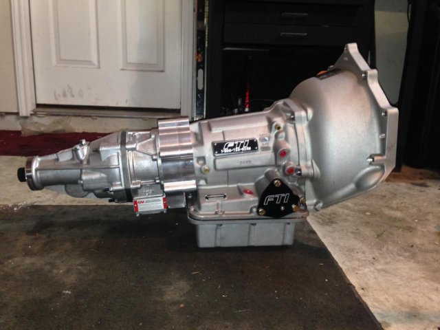

thezguy Posted May 22, 2015 Share Posted May 22, 2015 Guys I'm struggling to find a decent mounting location. Last night i was under the car brainstorming and decided that the adapter is the best place to tie into the trans for a mount. I literally have to drill and tap a few holes or weld something on it so i can have a mount point. With that said, directly above this location (in the trans tunnel) is some sort of "strap" or reinforced piece of the trans tunnel that is about 2" thick and runs the entire length of the tunnel. Can i tie into this "strap" for a trans mount or is it going to twist and tear? The only other option is to tie into the "frame" rails and build a custom mount that doesn't interfere with the dual exhaust placement. I realize i might be the only person running a shorty Glide and GV OD unit on an S30 so im prepared to design a one off mount but any and all ideas for trans mounts (glides particularly) are welcomed. Quote Link to comment Share on other sites More sharing options...

RebekahsZ Posted May 23, 2015 Share Posted May 23, 2015 (edited) First off, that is one bad-ass tranny! Seriously, i cant stop staring at it. But there's no mounting bolt holes?? Between this project and the 2JZ back-half project going on in the member projects forum, we have some really high quality daily reading on this site. I'm gonna change my screen name to "Green with Envy". I think the moderators who started this site were road racers, but we have a serious drag race invasion going on, and it's a high dollar-high class invasion at that! Keep up the high quality work-we may change some attitudes. Edited May 23, 2015 by RebekahsZ Quote Link to comment Share on other sites More sharing options...

thezguy Posted June 13, 2015 Author Share Posted June 13, 2015 (edited) Sorry for the delayed response I've been super busy with a new born and trying to squeeze in garage time. I ended just building off of the old T56 mount. Thanks for the ideas though and what's up mongoose! I see your getting serious about an LS S30! I used chopped up pieces of SBC rubber motor mounts at all 4 points of contact. Normally I wouldn't do this but the motor is solid mounted so I'm not to worried about it. Please excuse my bubble gum welds as all I had was 100% argon at home. Also this was mock up and no that bolt with 100 washers is not permanent. Edited June 13, 2015 by thezguy Quote Link to comment Share on other sites More sharing options...
thezguy Posted June 13, 2015 Author Share Posted June 13, 2015 Also I notched the 1X1 to slide into the existing trans mount so it has good welds on both top and bottom. It's pretty stout but still provides a little bounce which will be good for when I come off the trans brake. Quote Link to comment Share on other sites More sharing options...
