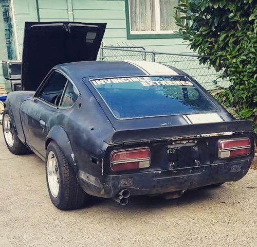

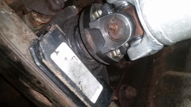

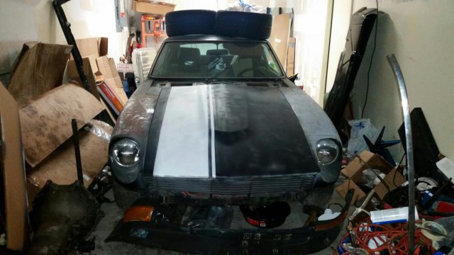

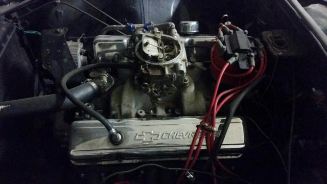

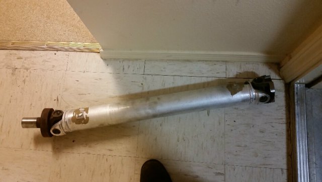

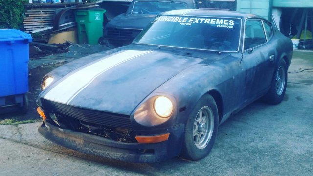

Invincibleextremes Posted June 1, 2015 Share Posted June 1, 2015 (edited) Building, or rather finishing up building a 73 240z with a chevy 350 swap and auto trans. It has an r200 and cv axle conversion in it already and an aluminum c4 corvette driveshaft. Still working on it but i got it running, now gotta do the brakes and the widebody kit or flares... Edited June 1, 2015 by Invincibleextremes 1 Quote Link to comment Share on other sites More sharing options...

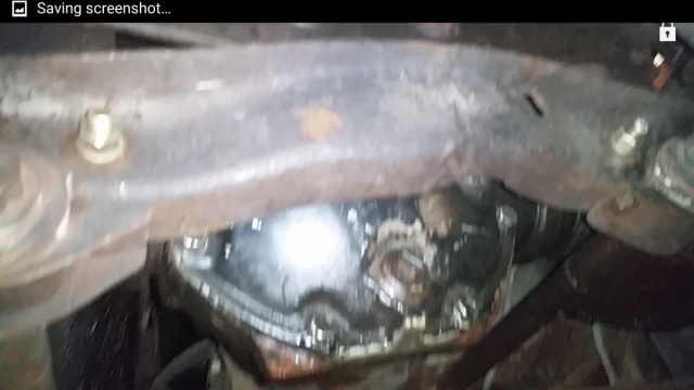

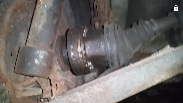

Invincibleextremes Posted June 1, 2015 Author Share Posted June 1, 2015 (edited) Heres a link to some of the videos. https://www.youtube.com/watch?v=VJ0SSsoQfh8Heres a video on the details of the r200 swap, haven't taken the rear apart yet so no real info on the stub axles used but it has a cv axle conversion also.https://www.youtube.com/watch?v=oYyQUl9lzsgAlso, here is a video of when i first started it.https://www.youtube.com/watch?v=UvImBdXvKCc Edited June 2, 2015 by Invincibleextremes Quote Link to comment Share on other sites More sharing options...

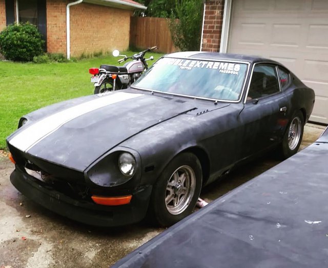

Invincibleextremes Posted September 10, 2015 Author Share Posted September 10, 2015 (edited) Got the thing working ok and test drove it a bit, needs more trans fluid but pretty excited to see it move under its own power and stop.. Edited September 10, 2015 by Invincibleextremes Quote Link to comment Share on other sites More sharing options...

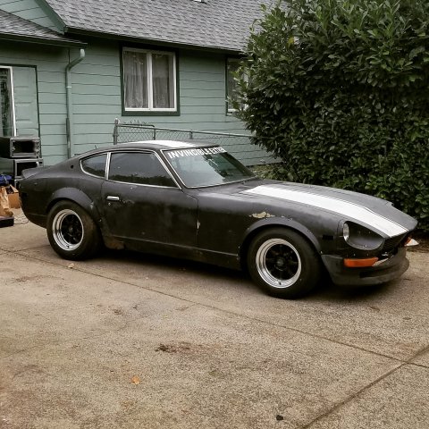

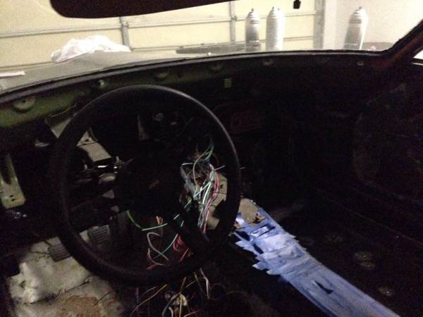

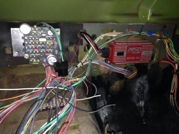

Invincibleextremes Posted October 14, 2016 Author Share Posted October 14, 2016 (edited) got it wired, all the lights work, and it runs and drives just fine now Edited October 15, 2016 by Invincibleextremes Quote Link to comment Share on other sites More sharing options...
Invincibleextremes Posted October 14, 2016 Author Share Posted October 14, 2016 No body work done yet, but making progress in the drivetrain and wiring for sure. Now I can drive it anywhere without overheating Quote Link to comment Share on other sites More sharing options...
