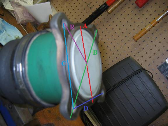

jthom5147 Posted June 24, 2015 Share Posted June 24, 2015 For some reason I chose not to take the beaten path in doing my 260Z LSD / CV conversion. I think I think I've scoured every thread talking about CV conversions using 280ZXT, Z31T, Pathfinder Axles, etc trying to find specs and dimensions for shaft spline count, bolt patterns, etc. So far in all of my reading, other than being referenced as the "4-Bolt" CV, I have not been able to find dimensions of the CV flange face, specifically: --Pilot diameter = A --Flange Major diameter = B --Bolt pattern dimensions = C, D, R See Picture for reference. Image Credit: http://lainefamily.com/240Z_V8_Conversion_files/240Z_Conversion_Rear_End%20_Upgrade_files/image013.jpg If anyone has or is able to measure these dimensions, it would be greatly appreciated before I buy and while currently scouring craigslist for some of these elusive CV axles. Thanks in advance, James Quote Link to comment Share on other sites More sharing options...
G-E Posted June 24, 2015 Share Posted June 24, 2015 PCD = 4.5" / 114.3mm Holes = 10.5mm Quote Link to comment Share on other sites More sharing options...
