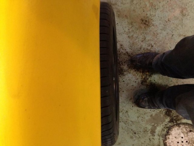

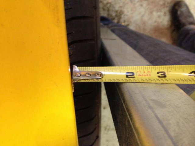

I had thought about this front subframe swap before, I threw the idea out when i found the overall front end, to be wider than i wanted it. I rememberit being 4 inches wider then the z's measurement. How much wider have you found it to be, over the stock z's ??..

I would say 4 inches sounds about right. I don't remember the exact measurements off hand.
However...
The stock Z wheels I believe are 0 offset. Stock Supra wheels are something like 30-35mm of offset, which is a little more than an inch. So if you subtract that, the wheels actually only stick out about 1.25 inches on either side. I'm hoping between flares and wheel offset, it won't be noticeable.
