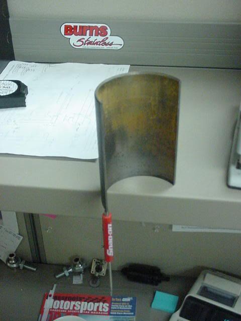

karay240 Posted November 17, 2004 Share Posted November 17, 2004 ok, here's the best source for me. . . my eyes, and a magnet. There's a freshly disassembled SR motor sitting in our shop. The reason I THOUGHT that there were not sleeves, it that they are cast-in sleeves. I was wrong. . . I'm sorry. I used a magnet on it, and it stuck. . . I didn't mean to misinform anyone on the forum. I'll definately check stuff 2 or 3 times before I post next time. Quote Link to comment Share on other sites More sharing options...
Hugh Posted November 17, 2004 Share Posted November 17, 2004 For clarity's sake, here's a picture of an OEM SR sleeve cross section. There's a magnet stuck to the bottom of it. It's not a lot of steel, but its in there. Quote Link to comment Share on other sites More sharing options...
