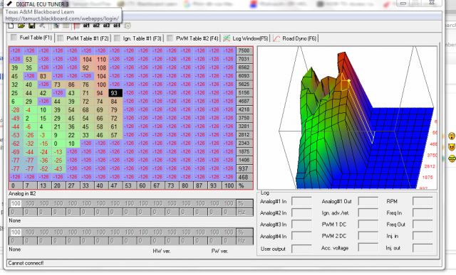

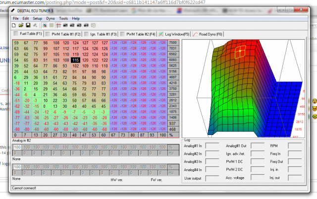

ihiryu Posted October 5, 2015 Author Share Posted October 5, 2015 Copied and pasted from our Facebook page : The car actually runs great on the stock ECU, it responds very well with the bolt on's and AFR's are actually pretty rock solid, there's actually not much I can do to make more power, which is very surprising. I'm running more boost than the car was designed to run. Unfortunately, I can't advance timing, so power under the curve is stuck right where it's at. As of right now, we're on stock injectors, ecu and maf, we've done all bolt on's (O2 housing back, including cat delete, front facing intake manifold, and upgraded front mount), turned up the boost from 8 psi, to 12-14 psi. The internal wastegate is sticking, so boost is a little off. So anyway, I started diving into what I really wanted to try, and that is MAF delete. The DET3 does allow MAF delete, and reads load based on the onboard MAP sensor. It also allows us to retard timing (other applications allow advancing timing as well, but unfortunately doesn't apply to us). Once you get your fuel map dialed in, you will begin to log your driving (so you do a little of in town cruising, wide open pulls, highway etc) and literally, right click and "Convert from MAF to MAP). It will automatically give you a new fuel map, and of course it's a bit rough. One picture is what the DET3 gives you, and the other one, is after I've smooth it out. I've saved both tunes (the one BEFORE the MAP conversion, and the one AFTER ). I still plan to dyno the cars, before and after the MAF delete, that way we can find out how restrictive the stock MAF actually is. I don't think there's much of a change, because the Nissan MAF is actually well designed, but hopefully this will take care of some of the stumbling of a dying MAF sensor! Quote Link to comment Share on other sites More sharing options...
