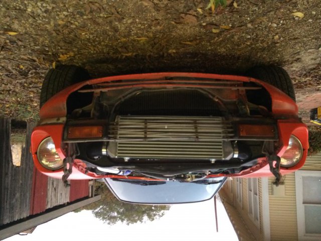

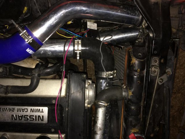

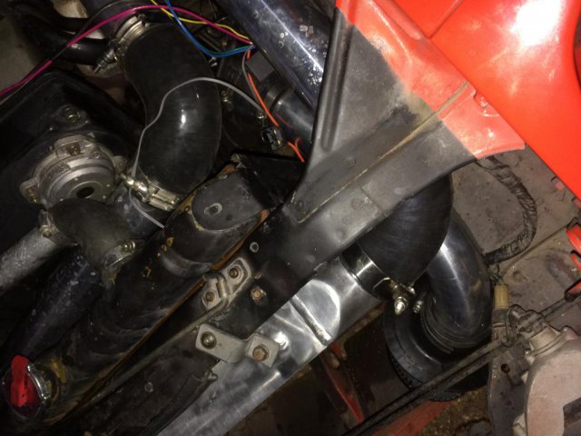

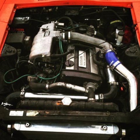

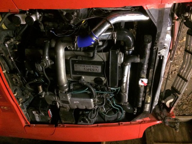

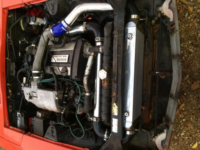

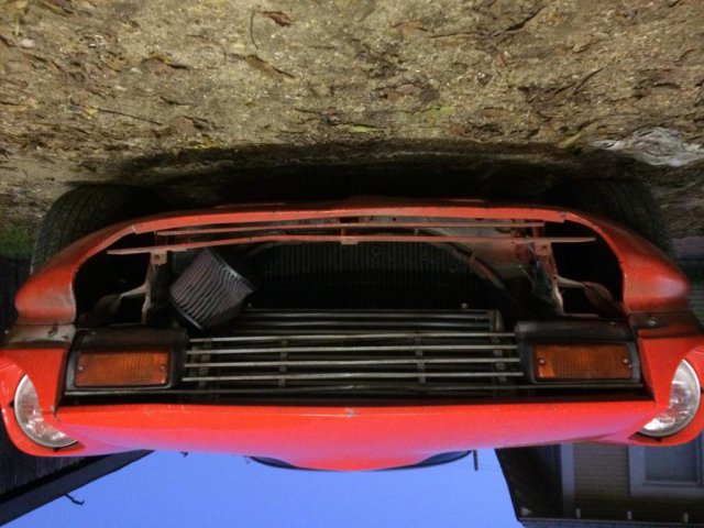

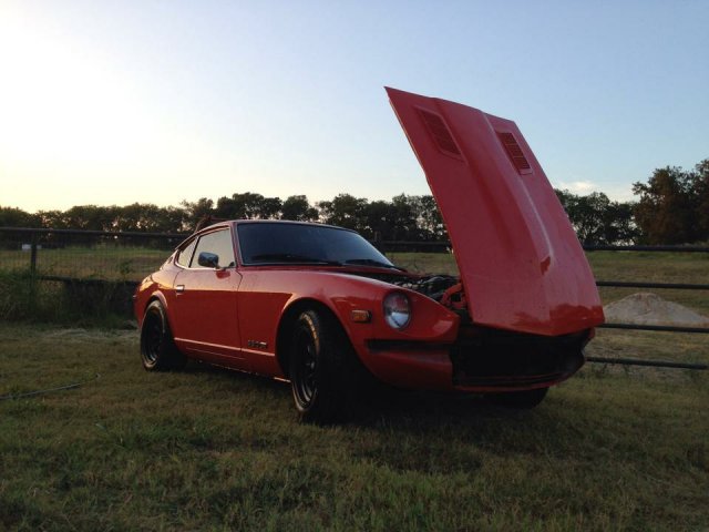

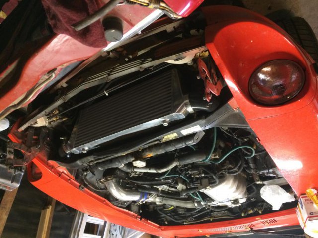

Wizzurp Posted December 9, 2015 Author Share Posted December 9, 2015 Ok, pics in order: 1 pre swap, pre suspension, just one coil cut off per spring, actually rode very well! Rest showing swap, I attempted to show the intake/intercooler piping and whatnot. Also **** the rotation issues, ugh!!!!! Quote Link to comment Share on other sites More sharing options...
