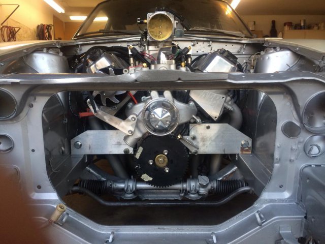

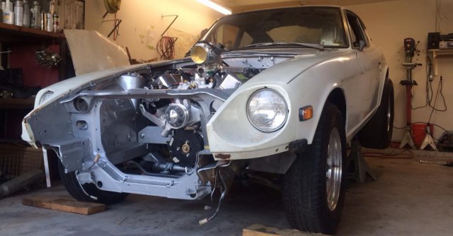

850z project
1977 280z with big chevy 520ci
Holley dominator ecu/ head up display
Th400 reverse pattern/ circleD converter
AFR 345 heads. set up for boost, eventually will get f1x
Stock irs on coilovers on rear
R200 3.36 quaife LSD z31 half shafts and billet stub axles
Any thoughts on how much it might weigh?
Not sure what's gonna happen with that r200 on good traction
Hell yes!! Love it. The rear end will be fine until it isn't. I think the weak point is the inner stub of the axle where it inserts into the diff. The diff will probably be fine. If you have the ability to go ahead and install a solid axle, I would so that you can blast it with confidence instead of fear and trepidation.
