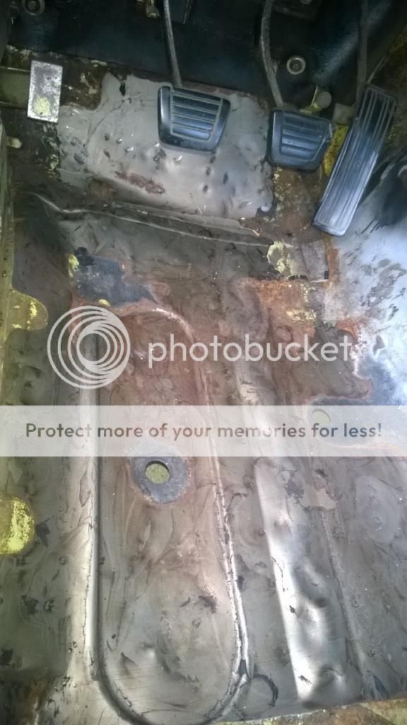

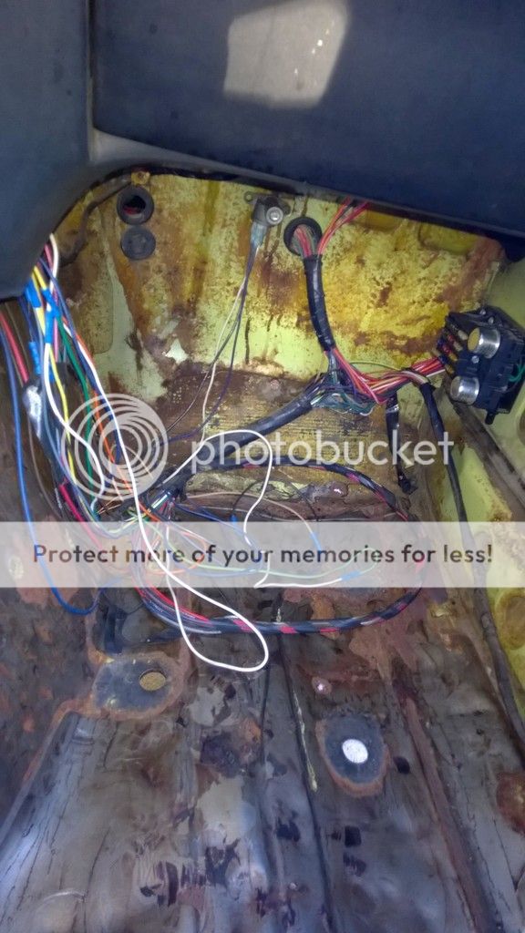

So I have a 1970 chassis, that has some pinholes in teh floor plans (at first glance I was thinking nothing about even replacing the pans), but I know zed findings floor pans actually help stiffen up the car. I also would like to do a full T3 suspension setup minus coilovers (already had them). Plus it'll be getting a subaru r180.
This car is gutted, PO actually drilled holes in the driver side floor to lower the seat mount (mounted it directly to the floor with a tube welded in front). so that would be a reason I'd want to replace them.

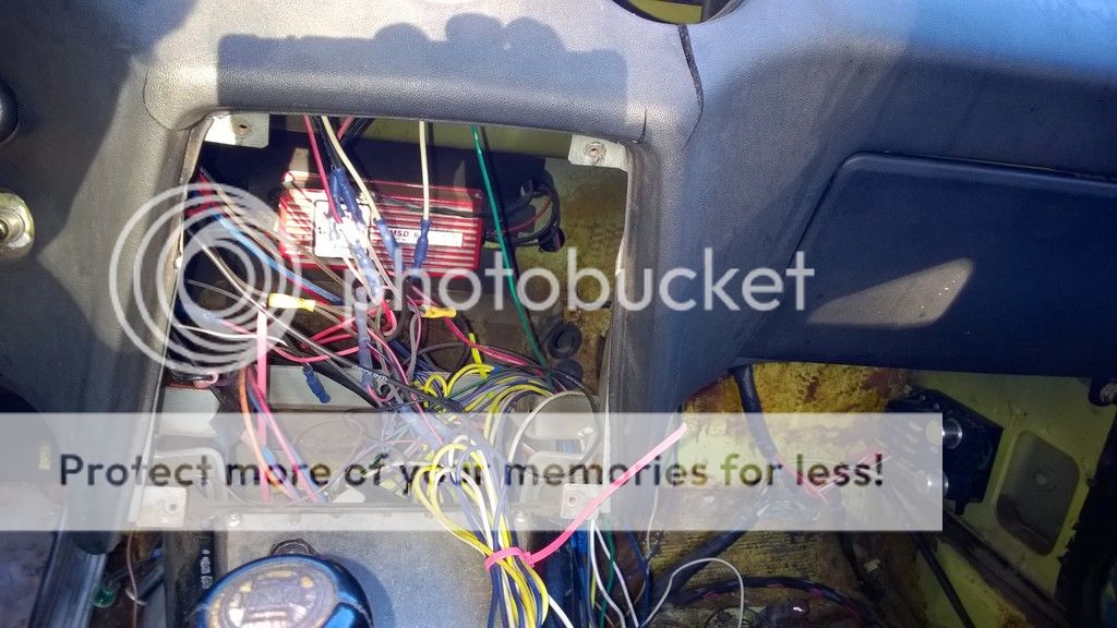

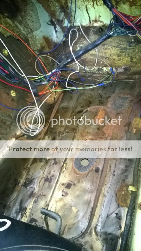

Right now the wiring is micky moused to the point where I'm surprised it's not shorting on the chassis. Some of that was also from me attempting to get it road legal to drive it home.

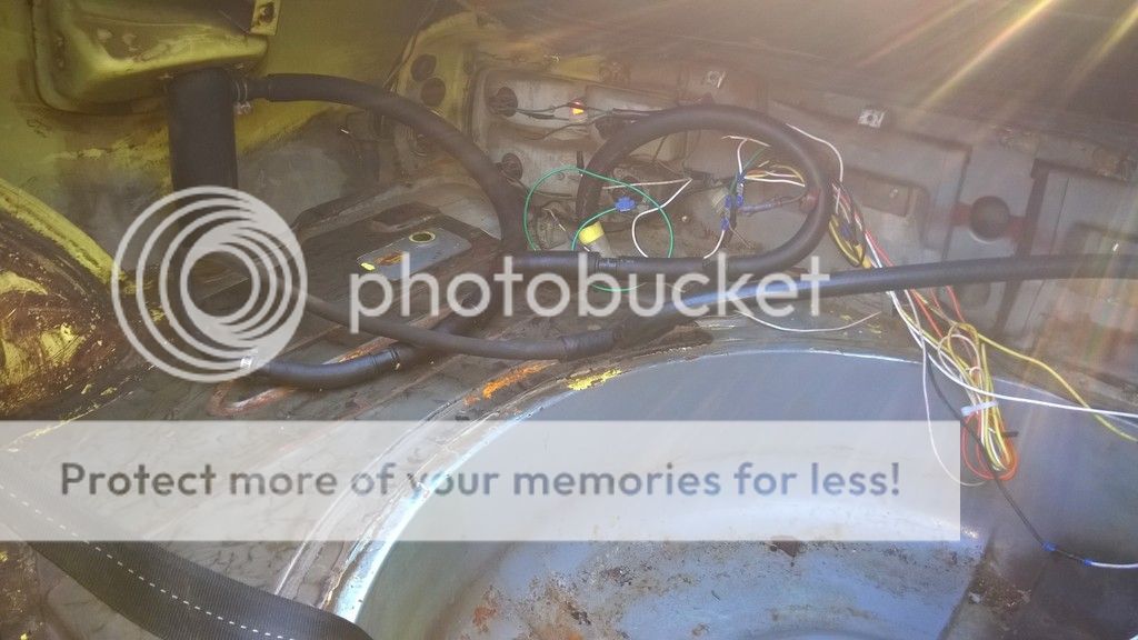

Here is the wiring, and also messed up gas tank venting
Floor pans:
passanger
driver

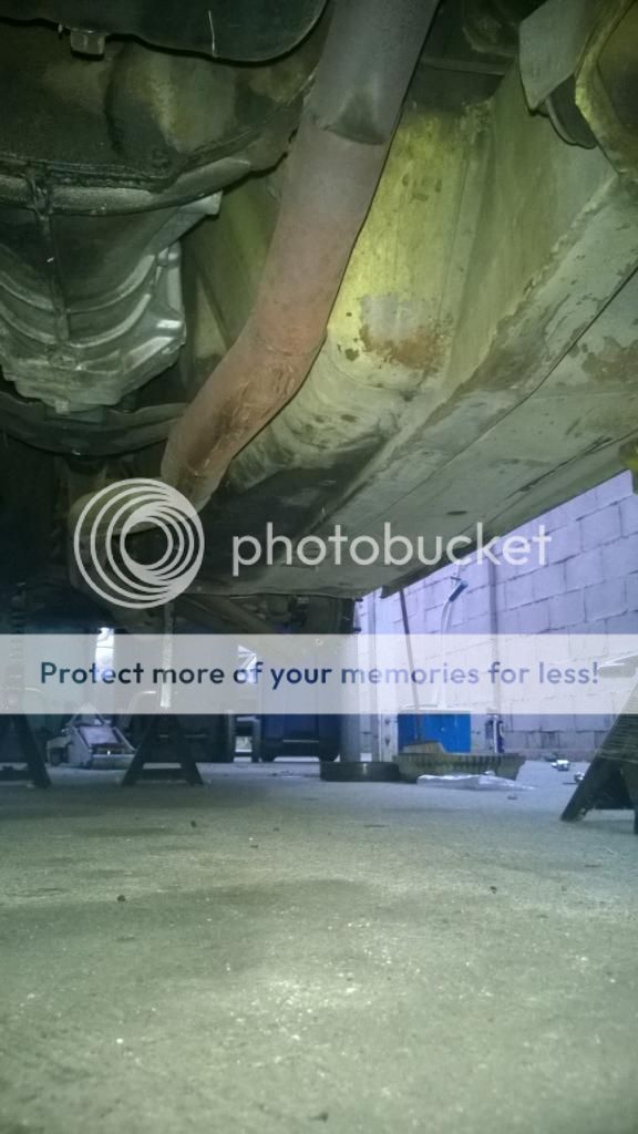

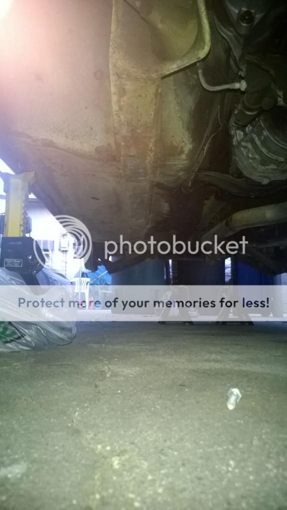

I don't have pic of the tail light area damage, but this is the driver rear wheel wheel, and  it is smooshed. doesn't show up that well in the pic.
I don't mind it too much since I'm hoping to get flares to cut that part out anyway.
