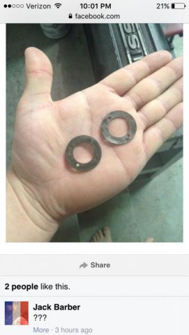

ReeNerf Posted November 15, 2015 Share Posted November 15, 2015 (edited) While putting on the front suspension parts together I realize I have these, but I don't know where they go. Good luck P.s. Don't mind my white ass feet Edited November 15, 2015 by ReeNerf Quote Link to comment Share on other sites More sharing options...
ReeNerf Posted November 16, 2015 Author Share Posted November 16, 2015 (edited) I don't know if my picture it being applied https://www.facebook.com/brett.barber.7/posts/714493555318961 Edited November 16, 2015 by ReeNerf Quote Link to comment Share on other sites More sharing options...

NewZed Posted November 16, 2015 Share Posted November 16, 2015 While putting on the front suspension parts together P.s. Don't mind my white ass feet There's a lot of parts up there. What are they made of? Are they oily? How far apart were things and were they stock parts? Might be a strut internal part. Did you intentionally spell "ass" in your picture? Clever. Ass feet - eeww.. Quote Link to comment Share on other sites More sharing options...
ReeNerf Posted November 16, 2015 Author Share Posted November 16, 2015 NewZed// metal / dry greased / 100% from a 72 240z Quote Link to comment Share on other sites More sharing options...
RebekahsZ Posted November 16, 2015 Share Posted November 16, 2015 (edited) Went to Facebook link. I will try to add the picture for ya. Hmmm..I dunno..too small to be gland nuts, too big of a center hole for the front crossmember doubler for the LCA inner pivot, too small for the TC rod cups. Some weird kind of lock washer? I'm thinking some part of the TC rod bushing assembly or or maybe inner tie rod end? Hole in center looks about as big as either a strut rod or spindle pin. Seatbelt bolts are 16mm..part of a seatbelt reel? I really have NO idea. Johnc/1tuffz/Mortensen/tube80z-can you guys identify that part? Edited November 16, 2015 by RebekahsZ Quote Link to comment Share on other sites More sharing options...

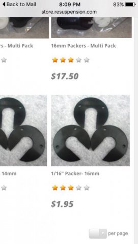

morbias Posted November 16, 2015 Share Posted November 16, 2015 Shock packing washer? Or a shock valve plate perhaps? Quote Link to comment Share on other sites More sharing options...
RebekahsZ Posted November 17, 2015 Share Posted November 17, 2015 (edited) Looks like packers without the slot. Edited November 17, 2015 by RebekahsZ Quote Link to comment Share on other sites More sharing options...
