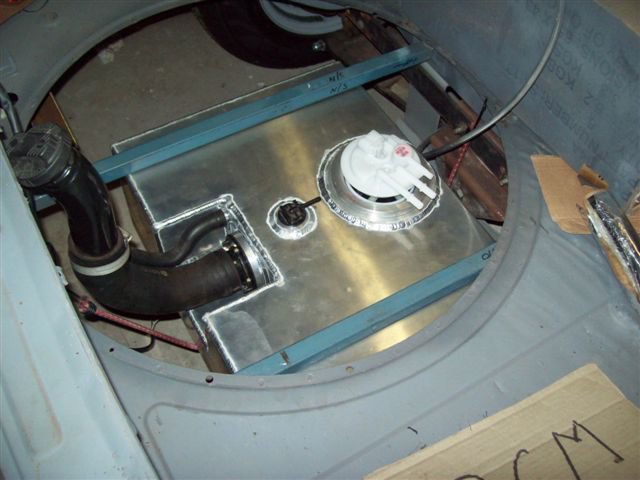

NCchris Posted December 12, 2015 Share Posted December 12, 2015 Like this? I have a similar tank and, because it is longer than it is wide, it would install better (room-wise) this way. Anyone else installed one like this? Did it work OK? Any other problems? I asked Gabe at TTT but he couldn't remember who's car this was. Thanks in advance! chris Quote Link to comment Share on other sites More sharing options...
240zdan Posted December 13, 2015 Share Posted December 13, 2015 (edited) Not unless its setup for Nascar. Even my fuel cell when I had it with the sump on the back would surge when braking. A friend of mine cooked his sr20 with the tank mounted like that in his drift car. Edited December 13, 2015 by 240zdan Quote Link to comment Share on other sites More sharing options...

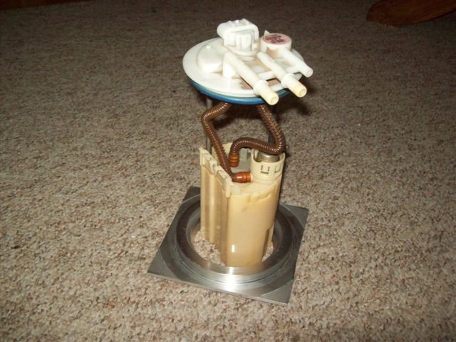

Boy from Oz Posted December 14, 2015 Share Posted December 14, 2015 Why not run an in-tank pump? Does away with all those nasty lines just waiting to be ripped off or punctured. I have the filler behind the number-plate. Quote Link to comment Share on other sites More sharing options...
240zdan Posted December 14, 2015 Share Posted December 14, 2015 Why not run an in-tank pump? Does away with all those nasty lines just waiting to be ripped off or punctured. I have the filler behind the number-plate. Still have lne running from the tank to the motor. Nothing will get ripped or punctured unless your'e wheelng your Z over branches. Quote Link to comment Share on other sites More sharing options...

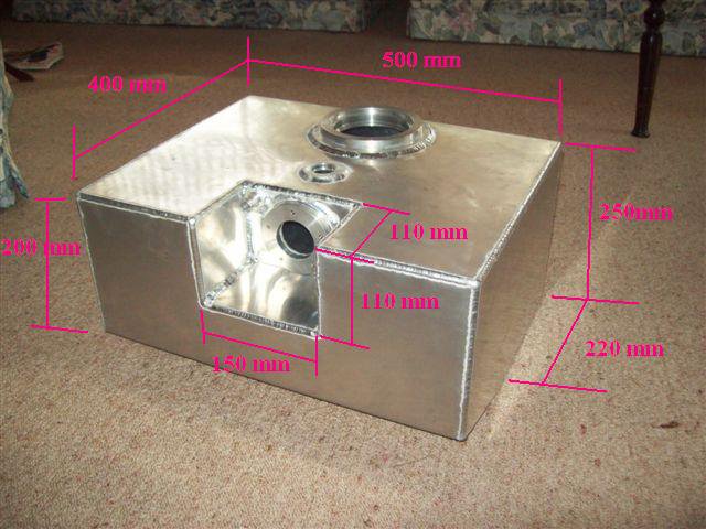

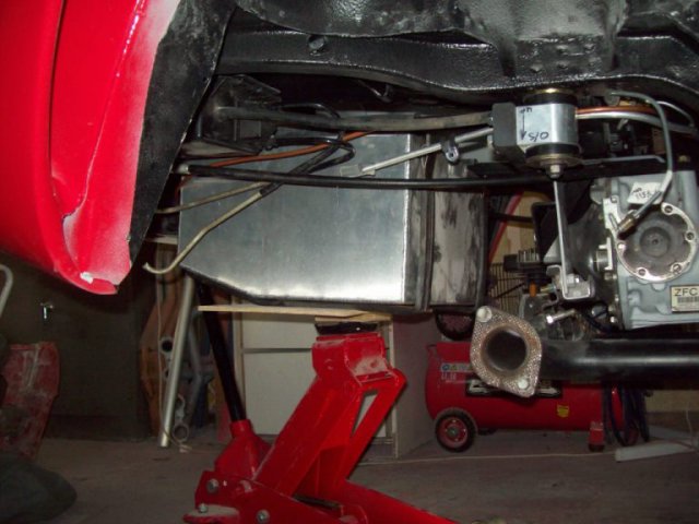

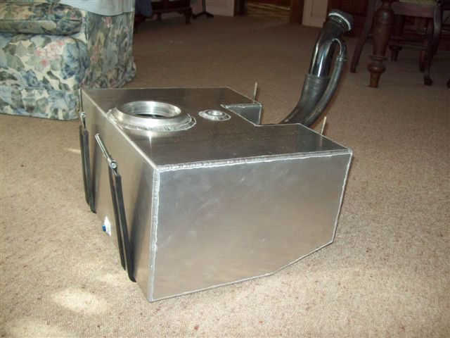

Nelsonian Posted December 20, 2015 Share Posted December 20, 2015 Why not run an in-tank pump? Does away with all those nasty lines just waiting to be ripped off or punctured. I have the filler behind the number-plate. Wondering what cell this is you are running, gallons and if you have any more pics. Quote Link to comment Share on other sites More sharing options...
Boy from Oz Posted December 20, 2015 Share Posted December 20, 2015 (edited) Wondering what cell this is you are running, gallons and if you have any more pics. Made it myself, Only 50 litres as I wanted to run twin exhaust for the GTO and we have very tough noise/emission laws down here requiring big mufflers, etc. which restricted the width. Edited December 20, 2015 by Boy from Oz Quote Link to comment Share on other sites More sharing options...
Nelsonian Posted December 22, 2015 Share Posted December 22, 2015 Made it myself, Only 50 litres as I wanted to run twin exhaust for the GTO and we have very tough noise/emission laws down here requiring big mufflers, etc. which restricted the width. Very nicely done! I really like the fill method from behind the plate. Quote Link to comment Share on other sites More sharing options...
