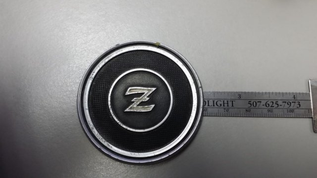

Is there a way to remove the center Z emblem from the horn pad nicely?
I want to use it on my new Nardi, but I dont wanna ruin the wheel just to get the Z.
I know how to remove horn pad from steering wheel, but after that I dont know if it the pad disassembles any further.
Let me know asap, having conductor ring made to work with older wooden Nardi so that I can still have horn.
FIGURED IT OUT, SUPER SIMPLE.
To pull horn pad off the steering wheel while on car, disconnect negative terminal of battery, push horn in and and twist counter-clockwise (may require some jiggling) - should just pull off after.
Once you have pad off, remove the locking mounting plate's 3 phillips screws, then lightly push small screwdriver through the only exposed hole.  This will push directly on the Z emblem so be very careful.
Ease of removal depends on how much the glue has broken down under the emblem.
