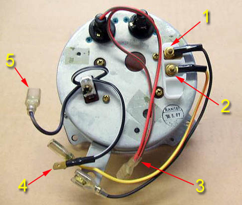

78-280Z Posted May 24, 2016 Share Posted May 24, 2016 (edited) Hi All, New to this forum and I have been searching for a couple of hours to no avail. All I found was someone had an erratic tach so they added a capacitor to the (-) terminal of the ignition coil and it made it work just fine but I am not sure if this would help me. My original tach was stuck at like 2700 rpms so I replaced it with another original tach. Now, it reads just fine unless it's under 1200 rpms. Under that, it reads at 0. When the engine is cranking at startup, it does flutter under 1000rpms like it wants to read but then drops to 0 when the car fires on. I know it gets the signal from the ignition coil (-) terminal so my question is, is it not getting enough voltage from the ignition coil under a certain rpm to get the tach going? i did disassemble the rear of tach when I received it to remove the green light bulb filters (I like the white/yellow color better). Did I add nuts in the wrong order making a bad connection on the two little prongs on the back (they have tiny nuts on them)? I am referring to 1 and 2 in this image: http://www.gwfweb.com/datsun/images/tach.jpg . If anyone has a better picture of that setup that might help. Thanks! Car: 1978 Datsun 280Z 2+2 Edited May 24, 2016 by 78-280Z Quote Link to comment Share on other sites More sharing options...
