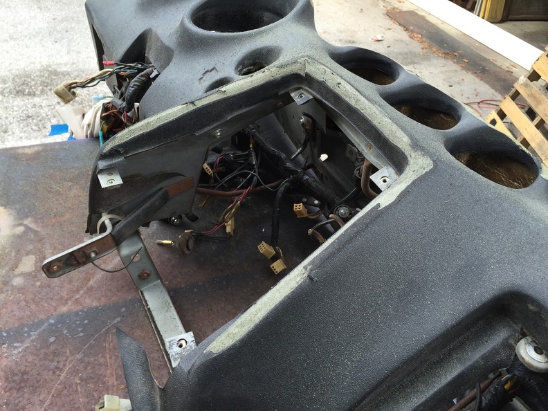

You have to pull the dash for this and it is not hard to do so no matter what, don’t convince yourself you can do it in the car. I pulled the dash and did a test fit of the cap. It was immediately apparent that it wasn’t going to just slip on. You could wrench it into position but in doing so it put huge stress on it. Over time that stress would lead to warpage and  de-lamination from the pad. I knew it wouldn’t be perfect but I was surprised at how far off it was. The plastic in the gauge pockets is extremely thin so be really careful you don’t tear it during fitting.
In order for the cap to sit in it’s natural position I had to do a fair amount of grinding to the pad. Mostly to the tops of the gauge pods and the outer corners.

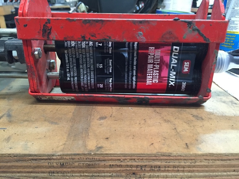

 Even then I had to throw in the towel and accept a small amount of stress. I took a DA sander to the entire dash surface with 80 grit to improve adhesion. In reality something even rougher like a 50 grit sander would be better.  Speaking of adhesion I decided to use SEM 2 part plastic repair #39847.
It’s made for repairing plastic bumpers and is sand-able like bondo with almost no shrinkage. I already have the dual mix gun but if you don’t have one you will need to get one. By the time it was all said and done I used the entire 7 oz tube and 6 mixing tubes.

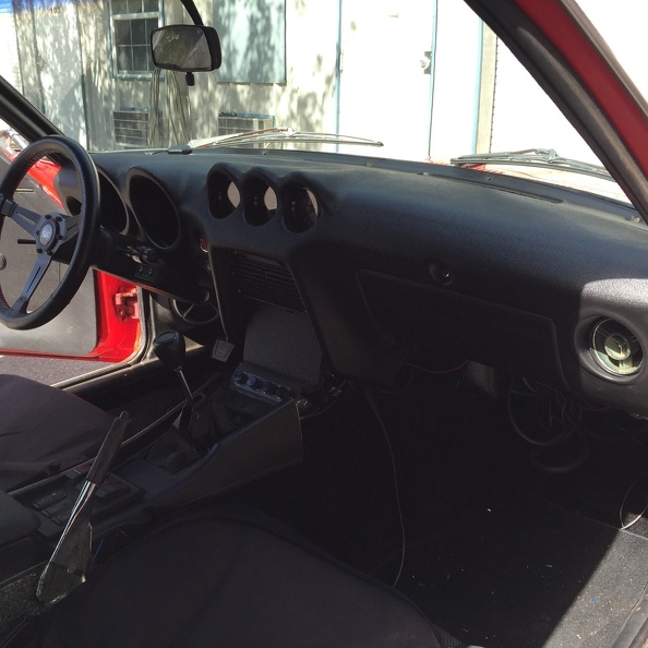

 I masked off areas of the dash that weren’t covered. Pay careful attention to the glove box area. I didn’t and my glove box door is now a very tight fit.
 No problem as it’s non functional but if I wanted it to work I would have had issues. You need to pull the cap outward as far as you can to have enough clearance.

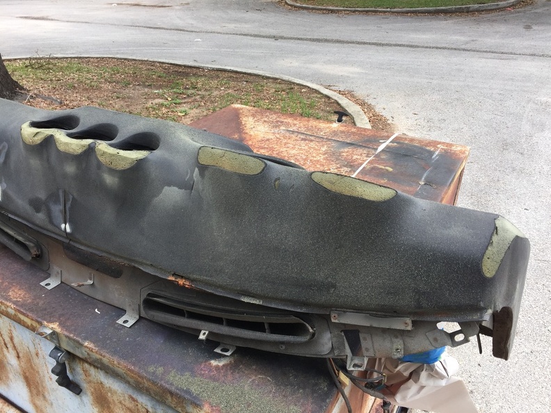

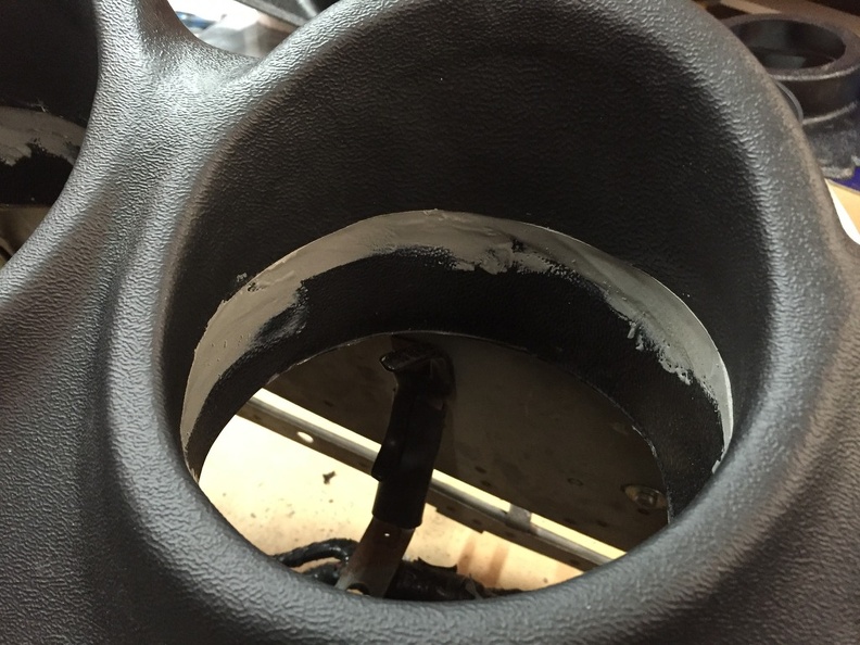

So now you have the basic adhesion done. Now you are going to glue ALL the edges. This is where you decide how well you want it to look. I was really nervous about the gauge pod areas warping over time and ending up in the sight line of the gauges.
 I took a heat gun and a pair of heavy gloves. I heated the plastic that fit poorly and then shaped it against the dash pad with my gloved hand. This is really tricky. You go from not hot enough to disaster in the blink of an eye. After I was done shaping I went around and glued most of the edges. More on that later.
So now that all your edges and high spots are glued you have a dash cap that is theoretically under little or no internal stress and held in position with the old dash. The problem is that you now have hollow areas that have little or no adhesion, plus there will be a temperature differential between the bonded areas and the hollow areas. Can you say “air gap”.

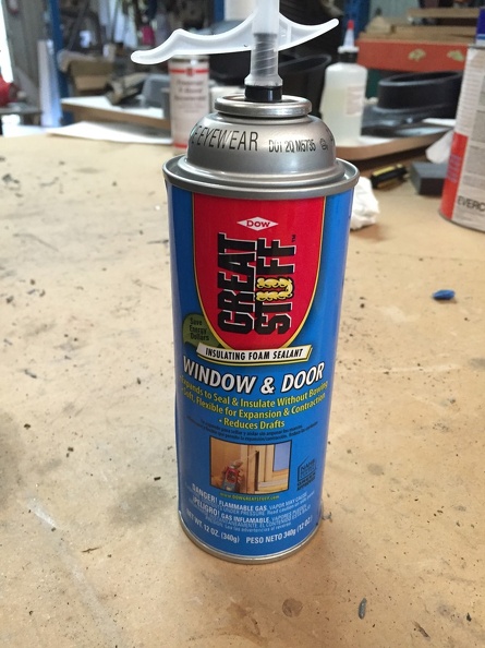

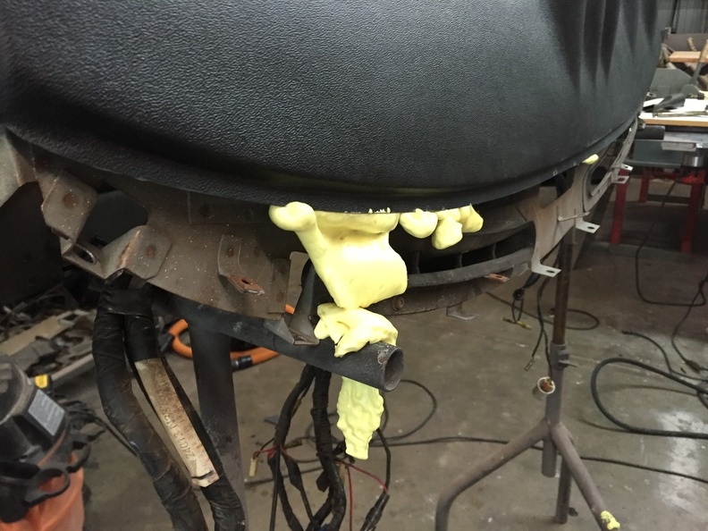

Time for the foam. I used low expansion window foam.
 It seems to be the right choice. It stays soft like the original pad. It also has a bit of adhesion going for it. Not much shear strength but every little bit helps. Position the dash with the gauges facing up so that extra foam falls away. Gravity is your friend.

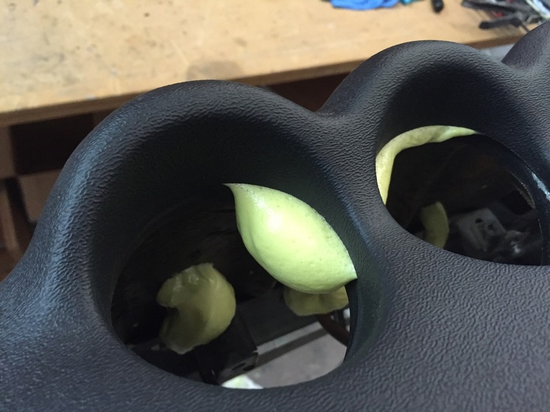

 I would shoot the foam in one hole and watch for it to appear in one of the vent holes. I moved from section to section. Don’t over do it as even the low expansion foam expands quite a bit. If it has no place to go then it may distort the dash. I found that if you kept the fill holes clear of foam then it allowed the still expanding foam a place to go. That may just be a guess though. After the foam dried I noticed a huge improvement in the feel of the dash. It felt solid with almost no discernible hollow spots.

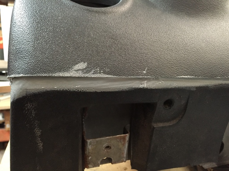

This is why you seal every edge.

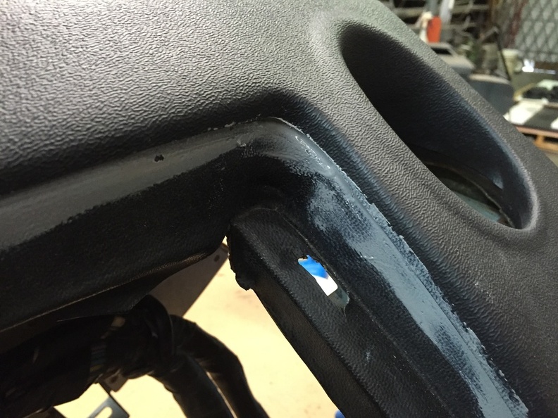

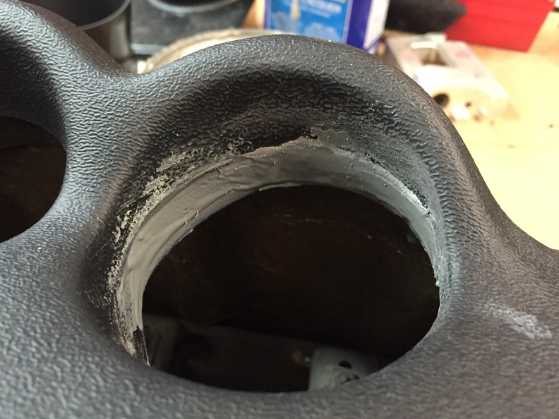

Time to finish. I took the remaining glue and used it as filler to build up the areas I wanted to feather in.
 I sanded them with 80 grit. Most of the areas I was working get covered so I wasn’t too worried abut it being perfect. If I was trying to do a flawless job I would fill the areas and then use the SEM texture spray. That stuff really works well. I cleaned off the dash and sprayed it with SEM trim black out of a rattle can. Looks great.

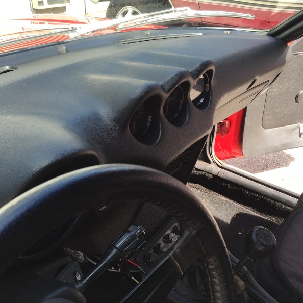

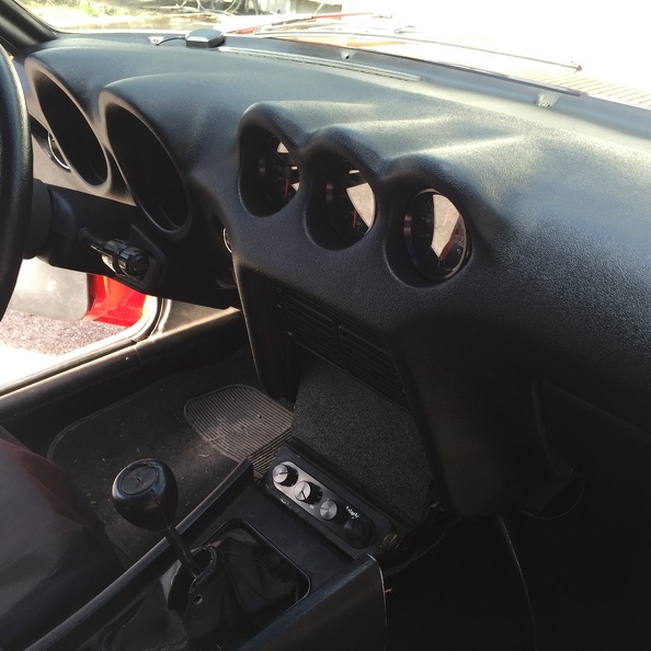

Here is the finished product installed in the car. I’m really happy with the results.
It’s the hot season in Florida so I’ll update the thread in the fall. I daily drive the car and it’s parked outside in the sun. I do use a window shade most of the time.

Just thought I'd update this post to let you know that as of july 16th when I pulled the car off the road the dash was still exactly in the same shape. No de-lamination at all. Absoloutly happy with the results.
