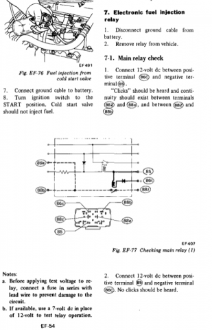

I have a 77 280 that I have been trying to chase down a no power to the fuel pump issue. I discovered within the FP relay I can manually get relay points to open contacts and get consistent FP operation. I need a working used FP relay unit (with the two relay modules). Part # A13-000 002. Any help would be greatly appreciated...would like to confirm solution before spending big $$ on new units for sale!

Are you figuring things out on your own or did you use the testing procedure in the Factory Service Manual?  Page EF-54.  The AFM switch is a common problem that can confuse people not familiar with how the system works.
