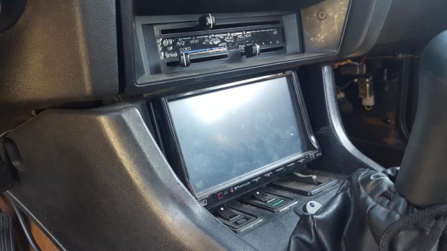

ZMONSTR Posted July 20, 2016 Share Posted July 20, 2016 Hello, My car was redone without a center console (not sure why). I have purchased one, put it in and would like thoughts on the alignment. Something is a bit off. I am attaching all the pics i took just to be safe. The problem I am seeing is that the shifter and dip in trans well for ash tray is a bit far foward compared to the opening(last pic). I placed the center console based on where i think it should allign with the console above it (1st pic). Its not pushed in very far, and I thought those elements should align. I can push more if I want, but ruins the alignmet of the bottom console with the middle. Thoughts? Quote Link to comment Share on other sites More sharing options...

jasper Posted July 22, 2016 Share Posted July 22, 2016 Pics can be misleading, but it looks like the shift lever is too far forward. Wrong shift lever? installed backwards. Again..could be the angle of the pic. Quote Link to comment Share on other sites More sharing options...
ZMONSTR Posted July 22, 2016 Author Share Posted July 22, 2016 Pics can be misleading, but it looks like the shift lever is too far forward. Wrong shift lever? installed backwards. Again..could be the angle of the pic. This is why I posted.. the shifter and opening for ash tray dont quite line up. I would have to push the center console in..but then I get big misalingment with the lower console meeting the center. I went with this position becuase the shifter is not hampered, and a new shifter boot should cover. As for the ash tray, I intend to do something else with it. Quote Link to comment Share on other sites More sharing options...
jasper Posted July 22, 2016 Share Posted July 22, 2016 What year and model is the Z? Is this a 4 spd, or 5spd. If the trans came from a ZX, the shift lever is your problem, and can be changed. Been there, done that. Quote Link to comment Share on other sites More sharing options...
ZMONSTR Posted July 23, 2016 Author Share Posted July 23, 2016 It's is a 5speed from a ZX! Please educate me some! Quote Link to comment Share on other sites More sharing options...
jasper Posted July 23, 2016 Share Posted July 23, 2016 Very simple. The Zx shift lever has different bends than your stock Z. Use the shift lever from a 74 and up 4spd. The distance below the pivot is different, but does not matter. It works. This is how we solved the exact same problem you have, after a lot of research. It is that simple. Quote Link to comment Share on other sites More sharing options...
