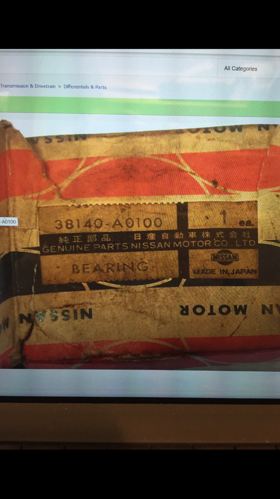

Rob L Posted November 10, 2016 Share Posted November 10, 2016 Hey guys , i just got my hands on 2 r190 old school nissan racing diffs. I have read all the info on it and know which bearing is impossible to get . Apparently its NTN 323/28c In this thread it says its also nissan part # 09022-0010p http://www.classiczcars.com/topic/16007-racecar-replica/?page=3 Now i got my hands on the bearing NTN 323/28c..but it came in a nissan box with nissan part # 38140-A0100. I got a lead on 3 more of these just want to make sure the part numbers match ...it could very well be that it just came in the wrong box ....just want to make sure . Diffs are in working condition so dont really want to take them apart but will if i have too. heres what i got thanks for any help Quote Link to comment Share on other sites More sharing options...
1969honda Posted November 12, 2016 Share Posted November 12, 2016 Have you looked up the dimensions in the NTN 323/28C bearing number? I would start there and measure what you have, if the measurements match it's probably good to go. That 323/28c should cross to an industry standard bearing design unless it is a Nissan specific fitment. Looking at just the 323/28C there seems to be quite a few options out there for the bearing. NSK, FAG and SKF all popped up with options when I googled it. Hope that helps! Quote Link to comment Share on other sites More sharing options...
Rob L Posted November 13, 2016 Author Share Posted November 13, 2016 I wonder why it was mentioned as being NLA in 10 year old threads ... Maybe they decided to remake it ...who knows but I ordered apparently the last 4 in the US from a reliable source made by an Italian company RIV bearings . I haven't received them yet , but apparently all measurements have matched up . Quote Link to comment Share on other sites More sharing options...

Rob L Posted November 17, 2016 Author Share Posted November 17, 2016 Ok its confirmed ...this bearing is NLA only from nissan ...other companies have made it and there still floating out there...maybe not many left since i bought out all of the ones i found LOL. All specs match up perfectly . So now owning a r190 is not that bad because i have sourced all replacement bearings and seals and gaskets ..... now if i need a ring gear or pinion ...i might be SOL. Haha. Quote Link to comment Share on other sites More sharing options...
