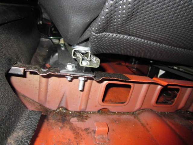

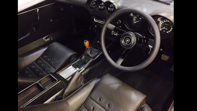

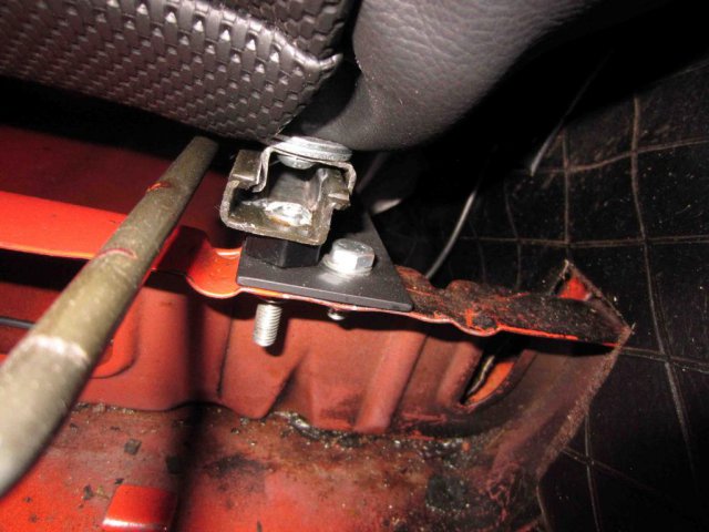

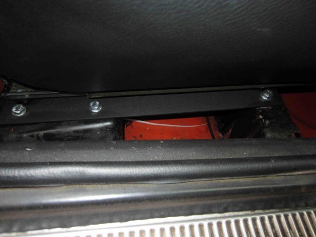

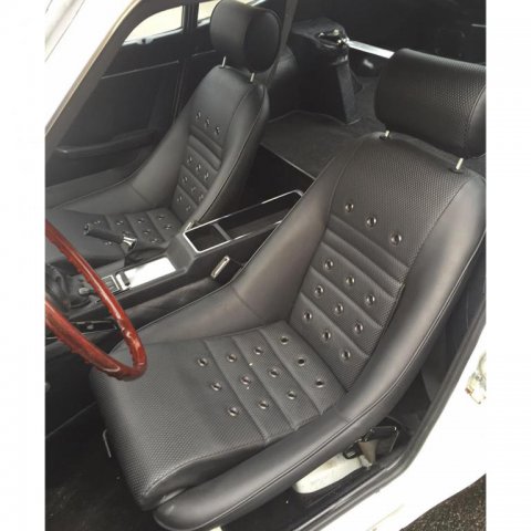

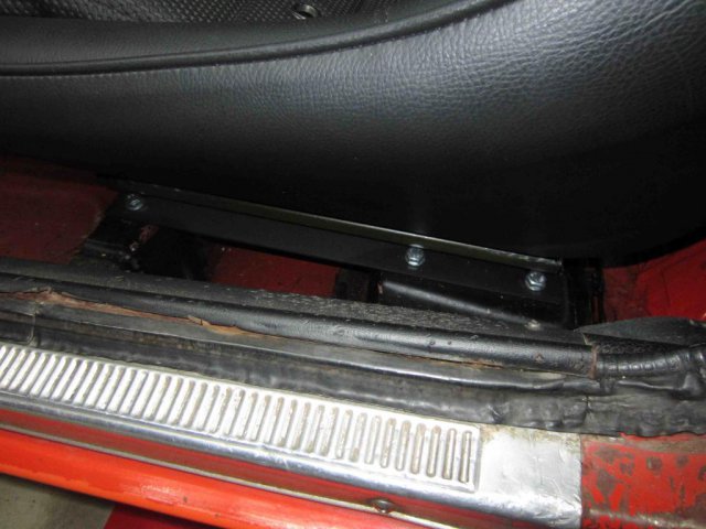

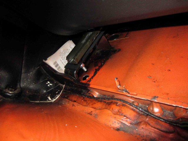

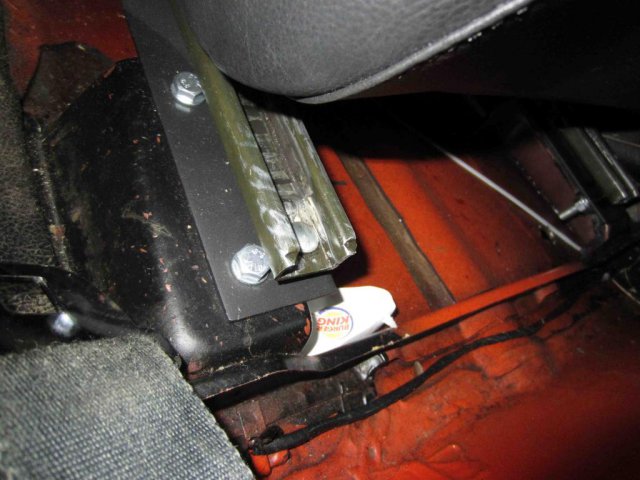

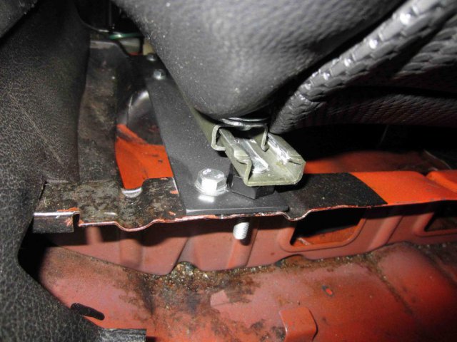

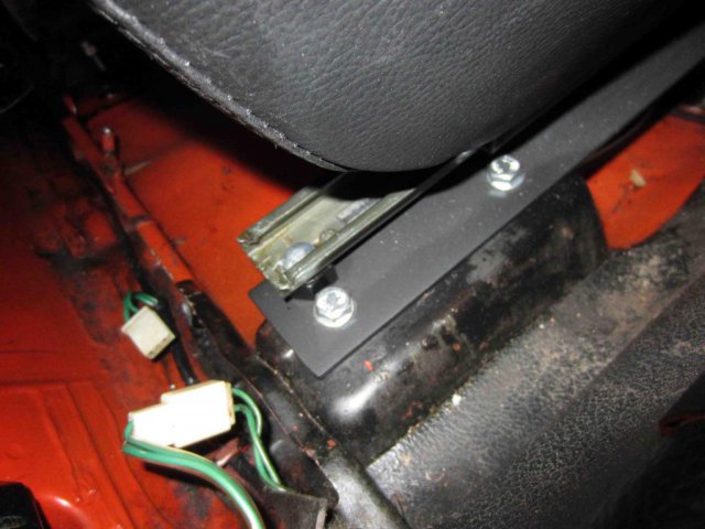

I will attach two pics from their site showing them in an S30 as they're better than my pics and a few of my pics showing the use of the factory 72 240z rails. Basically I used some steel plates to adapt the narrower mounting points of the Cobra seats to the factory floor mounts. Knocked out the studs that hold the factory rails to the 240z seats, elongated the holes and bolted the rails up with a couple big ass washers as spacers. Following pics will explain better than I can.
