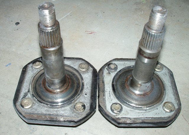

JSM Posted August 4, 2017 Share Posted August 4, 2017 (edited) Why do you need to install the 300zxt axles? Just install your current CV axles. They plug right in. Then post the 300zxt axles for sale here. I'm sure someone will want them. If your set on using 300zxt axles, the 280zxt stub axles (wheel side) are 25 spline same as the 240z. I doubt the 300zx are 25 spline. Maybe ask Litman to count them. The 280z stub axles are 27 spline count. If the 300zx OEM flanges are 27 spline, you will have to source a set of stub axles from a 280z to use the 300zx flange. Also you'll want have litman measure the length of the flange to compare against the ZXT you have to make sure it all fits. My quick google search for 300zx spline count didn't find much. If I were you, I would just use your ZXT axles and be done. These are stub axles. Edited August 5, 2017 by JSM Quote Link to comment Share on other sites More sharing options...

dave280zxt Posted August 4, 2017 Author Share Posted August 4, 2017 (edited) Hi JSM Thanks for the education. I guess I wanted to install the 300zxt axles as they are THE ones to get as they are stronger.( I rebuilt them,and painted them real pretty too. ) Edited August 4, 2017 by dave280zxt Quote Link to comment Share on other sites More sharing options...
