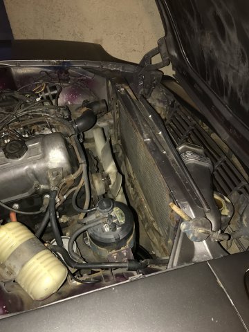

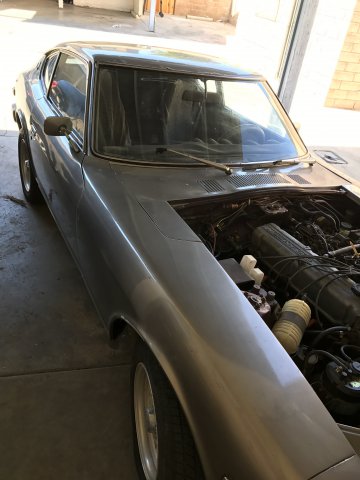

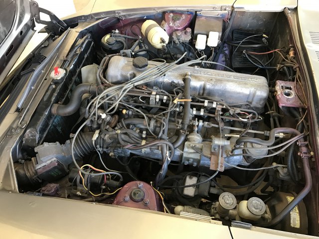

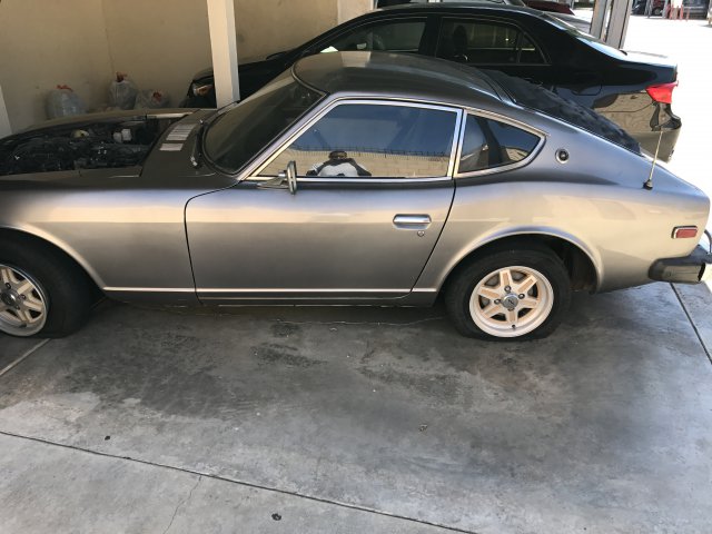

You don't need a cheap paint job, It looks like you have an expensive one already. (nice car)
If there are no hiccups with fuel delivery to your existing injected engine, touch nothing, leave it alone . It works, don't fix it. Fit your Chevvy, then find out what you might  need.
(then try a Bosch motorsport pump if it's thirsty. Perhaps add a swirl pot to your tank.)
$500-$1K for cold air ?  Cold air will be at the front , inexpensive ducting/ alloy piping  will get it from there to the throttle body for under $100.
I've used ebay alloy radiators for 20 years, $200 tops, never had problems,(don't knock Chinese imports- you are probably reading this on a Chinese built computer) BUT- if you live in the desert, copper is a better conductor, heavier, but more efficient.
