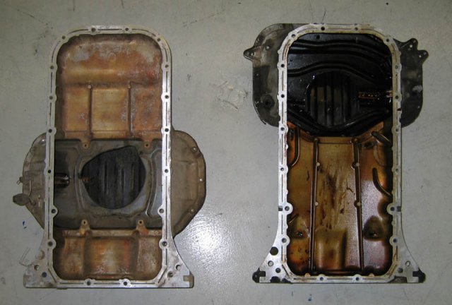

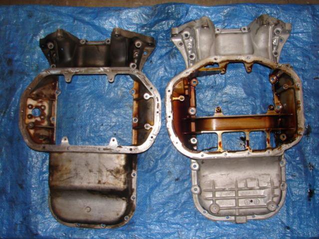

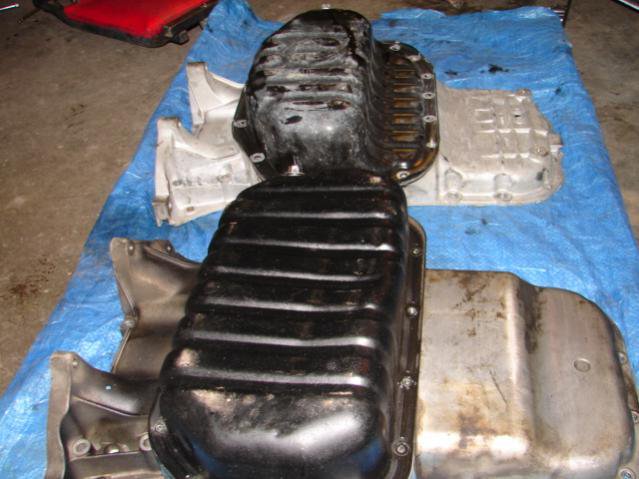

  3. Here's a couple of pic's of sumps that might help. first 2 are differences between a 1UZ and 3UZ (1UZ on left in first picture.) other 2 are comparing a front and rear from a 1UZ 3UZ is a much better engine , 4.3 litre Vvti (You will only need the "1uz stronger rods" if you are planning an all out race car with Nurnburg ring level power- 600HP plus, supercharged, turbos etc. etc. ) The rods are swappable into the 3UZ if you are really pedantic , 3UZ extra capacity was bigger bore. if you are not building an all out race/track car,Stick with the 3UZ Earlier 4.0 engines are g

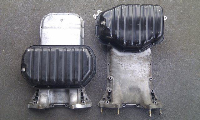

  4. Rear sumps are really a mid sump(they don't go that far back) The one on the right in the pic is from a 3UZ I put into a 928, on the left is early 1990's 1UZ (soarer? ls400?) I picked up to experiment with. as you probably already know , 1UZ, 3UZ sumps are interchangeable,

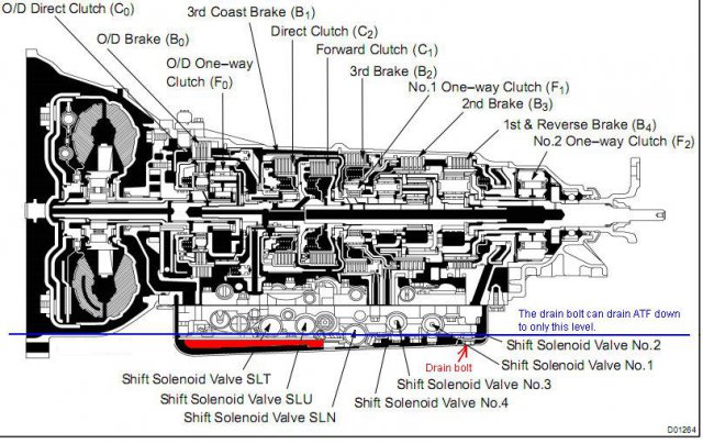

  5. Hi Panic, You obviously know the A341 backwards, I wonder if you can help me out with an A650E? I have one installed in a Porsche 928 with a 3UZ transplant, ( transaxle replaced with conventional Borge Warner LSD, the A650E where it's supposed to be, behind the engine) I have zero clearance for the dip stick, and due to this transmission holding so much fluid in the converter, it is guess work trying to work out if the fluid level is correct. (at the moment, only way is drop gearbox, drain converter, refill to factory spec. -) I have room at the side in the tunnel so I thought ma

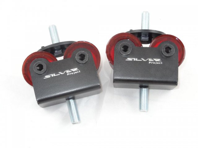

  7. ^^^ smooth running could be the key. Solid, as in, aluminium -or solid, as in, not silicone filled? I've used the solid (rubber) v12 Jaguar mounts on; a 260Z with 1J turbo, 928 porsche with 3uz V8 300zx TT- factory engine, (but modified the mounts due to ridiculous cost of factory mounts filled with silicone gloop) two TR8s (3.5 litre and 4.6) Never experienced anything even resembling a slight ( out of place) vibration
  8. these look different, can't seem to post links but if you put "Supra engine mounts Silver project" into ebay, should bring them up Solid, urethane,(but not cheap.)

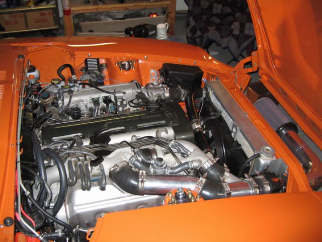

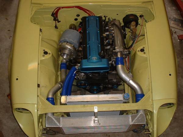

  19. Thanks Z-GAD, Great information, Local Nissan not helpfull with sourcing ,will probably have to see if I can find find ex Japan. Also ,a belated thanks, the picture of your car ,engine bay with 2J sitting in there, sans extra's,just that huge turbo, Together with Cyrus' slightly more civilised project,were the inspiration for me to do the 1J install, (I opted for brakes on mine- thought the parachute might cause problems snagging on pedestrians)

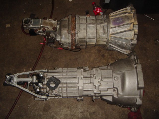

  20. Early R154 and V160, not the greatest angle to get an idea of width, but definately longer. borrowed this picture from www.2jzswap.com
