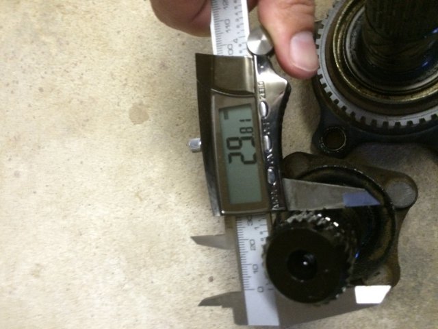

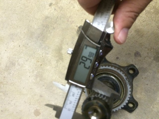

jthom5147 Posted November 27, 2017 Share Posted November 27, 2017 Not sure what they “should be”, but here are some measurements from a 280z r200 and a z32 vlsd NA. Quote Link to comment Share on other sites More sharing options...
brown280z Posted November 28, 2017 Author Share Posted November 28, 2017 Thanks jthom5147! It looks like your measurements are very close to mine (+/-.003”). Assuming our splines are normal, that would mean my OBX spline is to blame ... I’ll try to contact OBX again but I am doubting I’ll get a response. Any ideas to fix? Quote Link to comment Share on other sites More sharing options...
