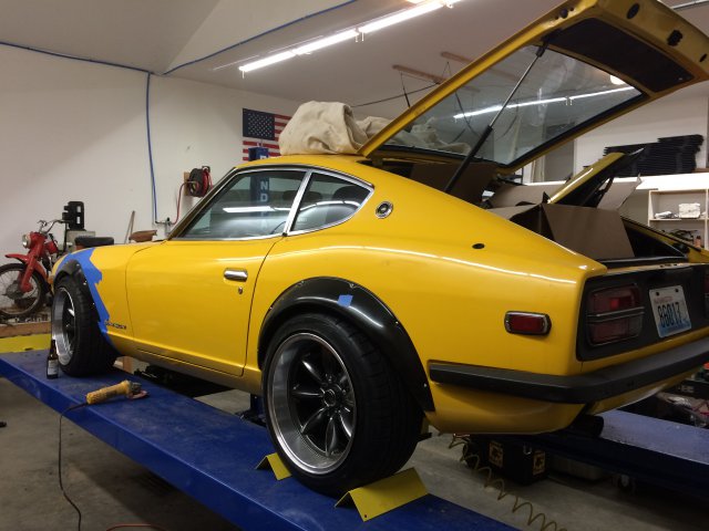

Hi, I'm am new to hybridz, I have a 1973 240z, and I am having a anlighnment issue with my driver side rear.  It is toe in... On the alignment shop printout it said the left rear is .66 degrees out. After researching and doing some measurements I thought my LCA was bent, so a friend sent me his LCA.  I put that control arm on with new  polyurethane bushings, ant took it back to the alignment shop... now it is .65 toe in.  I don't want to just start throwing parts at it without figuring out the problem. Visually nothing appears to be bent or twisted.  At some point I plan to buy T3 LCA's, I'm not sure what else to look for? I could take it to a frame shop to have them check the  unibody, but I don't yet know of a great shop to take it to in my area.  If anyone has any ideals of what I should look for. That would be great. Thank you.

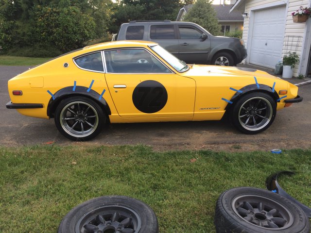

I just finished putting on the ZG flairs, and new wheels and tires... went to get it aligned... I am motivated to figure this problem out.
