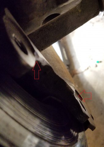

1. Remove the old caliper.Fit the new caliper and you will now see 2 things that needs to be fixed.
  a, There is a tiny ridge on the strut that needs be removed (dremel works well)
  b. The caliper mounting holes are off a tiny bit. Grind away some material in either top or bottom mounting hole on the caliper.
