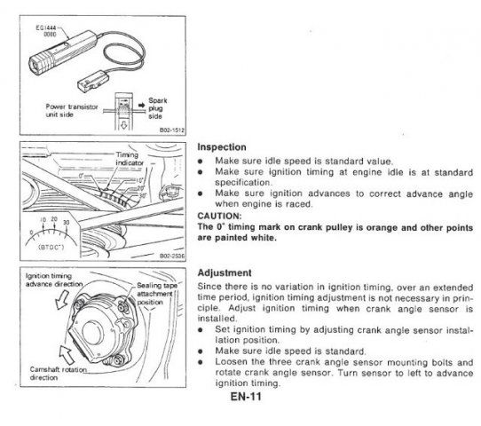

winstonusmc Posted March 11, 2019 Share Posted March 11, 2019 the static timing value should match the indication on the pulley. If you set static at 20 degrees, the timing light should indicate at the 20 degree value on the pulley. Its the 5th mark according to the picture I have attached. My 0 degree is painted red and the rest are white. Quote Link to comment Share on other sites More sharing options...
