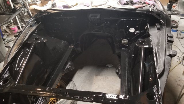

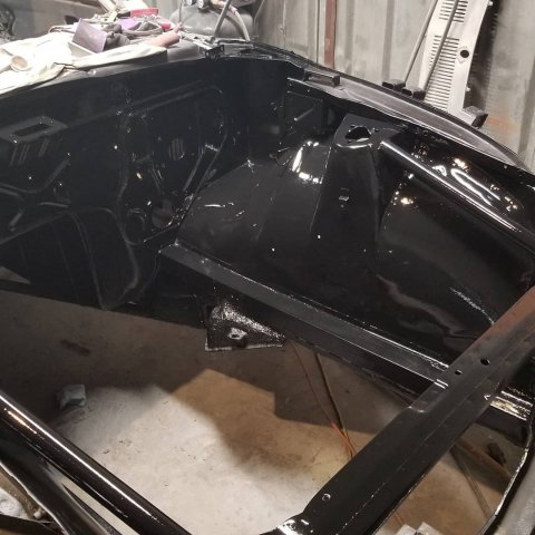

So, I elected to use the 8:4:1 method. 8 Parts paint (Rustoleum Satin Black), 4 parts reducer(Duplicolor BG906), 1 part hardener (Omni MH202). Hardener was the most expensive part by far ($40/pint) but I've got a bunch left over so that's a plus.
Applied with a good old HF HPLV $14.95 spray gun @ 40psi at the gun
First pictures are after the second coat was applied and still wet.

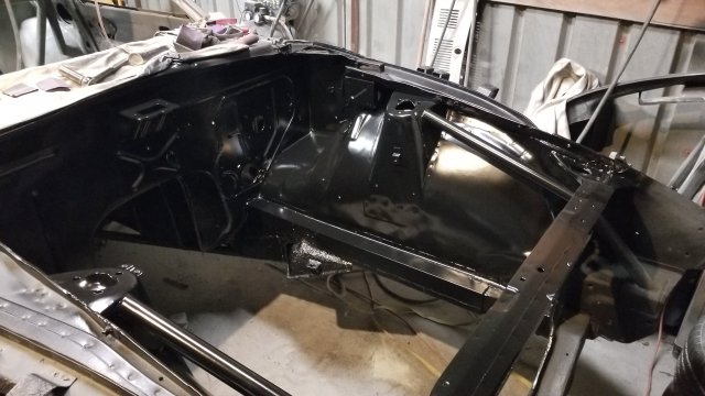

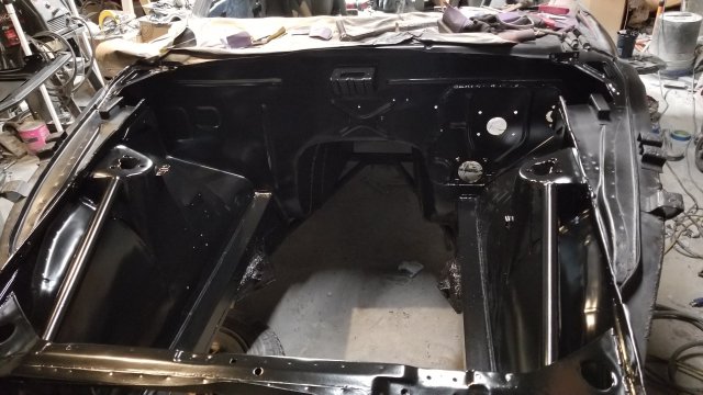

After about an hour:
It look a solid 30-45 minutes to flash in between coats (again, cold). After 24 hours it wasn't fingernail hard but a week later it's just as hard as the factory paint on my Tahoe. I have enough left to do the interior, but I'm not sure if I'll do the exterior in it (wouldn't be black. Maybe the dark gray).
