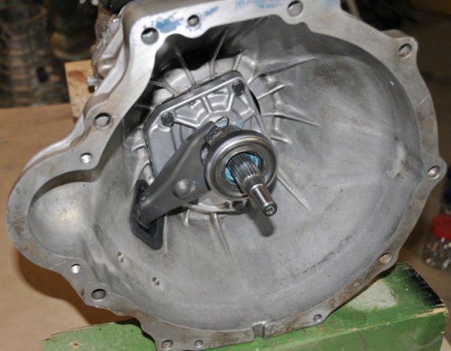

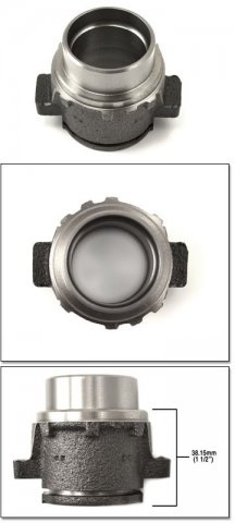

There is a groove on the clutch collar.  Slide the spring on that groove.  The ends then fit on the other side of the clutch fork, holding the collar to the fork.  If doesn't fit 1 way, flip the spring over, so it fits correctly.  Kind of a dumb thing, if you don't have a photographic memory, take pics before removing items.
