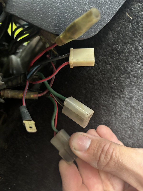

C-Borup Posted September 28, 2024 Share Posted September 28, 2024 (edited) Hi guys I have these unused plugs behind my radio. Anyone knows what these plugs are for? Edited September 29, 2024 by C-Borup Quote Link to comment Share on other sites More sharing options...
jhm Posted September 29, 2024 Share Posted September 29, 2024 The factory wiring varies from year to year, and model to model. What year and model S30 is your car? A Factory Service Manual (FSM) is invaluable; and they contain detailed wiring diagrams for the entire vehicle. If you don't yet have an FSM, you can download them free for all years at: https://www.xenonzcar.com/s30/fsm.html Quote Link to comment Share on other sites More sharing options...
C-Borup Posted September 30, 2024 Author Share Posted September 30, 2024 15 hours ago, jhm said: The factory wiring varies from year to year, and model to model. What year and model S30 is your car? A Factory Service Manual (FSM) is invaluable; and they contain detailed wiring diagrams for the entire vehicle. If you don't yet have an FSM, you can download them free for all years at: https://www.xenonzcar.com/s30/fsm.html Hi jhm thanks for your reply. it is a 11/71 😊 1 Quote Link to comment Share on other sites More sharing options...
jhm Posted September 30, 2024 Share Posted September 30, 2024 When analyzing the wiring diagrams, pay attention to plug type and wire color (wire color *may* be off from year to year due to factory production considerations, but IME it's usually correct). If your car's a '71, those plugs are probably things like Choke Warning Light, Radio, Power Antenna, etc. Also, be mindful that the wiring for Automatics is different than for Manual Transmission. Welcome to the Forum! Quote Link to comment Share on other sites More sharing options...
