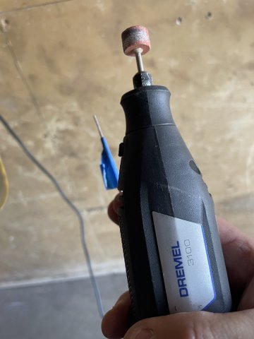

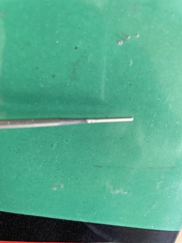

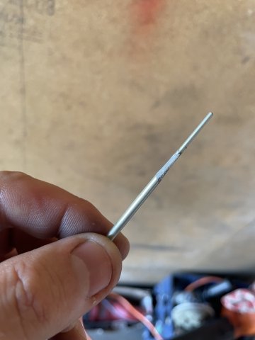

A to Z Posted June 1, 2025 Author Share Posted June 1, 2025 05-31-2025 Test and tune. I ordered some richer needles and today they were here so it was time for more trial and error. The needle rides inside of a "needle jet", and the one that was in there a "Y-8" was one step richer from the stock "Y-6" jet. Well, I went to the next richer size needle jet a "Z-0" and that is the largest one they have. then I took my new needle a "95" the richest needle they make and set it on the lowest (richest) setting. I went and drove it and it added about 50% of what I needed more of to make it just right. I ordered 2 needles, and so I taped off the other 95 needle and with my dremel began modding the needle. I added fuel in the 1/8 th throttle to 1/2 area, and then polished the ground area to make it smooth and put it in the carb and went for another run. Out of the 50% more improvement I needed it gave me another 25%, so just a little more.....pulled the needle back out and lengthened the area to grind down towards the tip a little, re-polished it and installed it....now she runs GREAT! only in one area was it not giving quite enough fuel, 2000-2500 RPM in second gear....roll on the throttle to the floor...... so I went back to my shims I had made to go under the choke and trial and error got me at 2 shims. It is now just right. feels good. strong and smooth, with a 3000+ RPM power band to redline. I did have a bit of a problem, as I wanted to simulate DYNO conditions, i.e. 4th gear, 2000 RPM, floor it and see if it would pull clean, the second time I did it I got a loud POP, and lost power. I started limping home and had to stop at one light, and it started smoking blue, then went to almost white for a second, then all smoking went away the rest of the way home. NO MORE SMOKE ?!? Initially I figured I had blown a head gasket.....but it wouldn't have quit smoking. looking under the hood, the vacuum line for the power brakes and the vacuum line for my vacuum advance on the distributor were blown off. Apparently I had put the car in an almost lug condition under load with full throttle, which shot the boost as high as you can imagine, and I LUCKILY had these hoses blow off, instead of the head gasket. These hoses are not clamped on tot heir ports so the boost was able to just push them off. I also found that one hose connection was leaking at the end, so I sealed it up and will give that 24 hrs to cure. DISASTER AVERTED! Those NISSAN factory Head Gaskets really are top quality. I highly recommend them! When I take it to the DYNO, I will just let them know not to full throttle it in 4th until 3000 RPM. Gradually add fuel until you are at WOT by 3000 RPM. here are some pics of the needle mod. Quote Link to comment Share on other sites More sharing options...

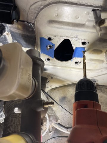

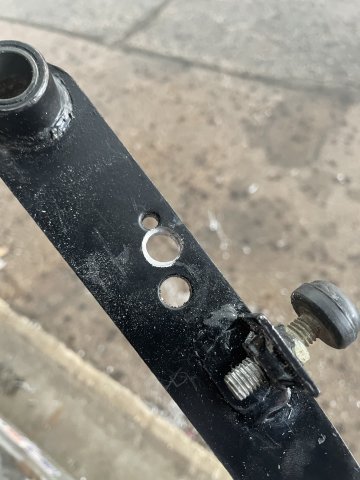

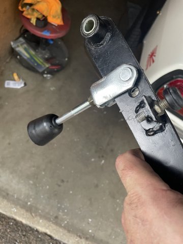

A to Z Posted June 15, 2025 Author Share Posted June 15, 2025 06-14-2025. I have decided to try out a manual brake master cylinder, i.e. no booster. If it doesn't work out I can put the booster back on......I researched into using the Chase Bays master cylinder that replaces the master cylinder and changes the pedal ratio from 3 or 4 to 1 to 6 to 1. In their instructions they talk about raising the master cylinder 1/2 inch. So I started reading about pedal ratios and come to find out....raising the hole on the pedal shaft 1/2 inch raises the pedal ratio to 6 or even 7 to 1! So, I got a piece of 1/4" thick aluminum plate and went about making a plate where the master cylinder was 1/2 inch raised fup from the center line. I then removed the pedal and drilled the hole 1/2" raised up for it, and I have an aftermarket rod setup, that I will have to cut down to use, but in playing around and albeit some yelling in pain I got the master back up and mounted with the new plate. I made sure to use my polishing wheel and some Mothers Mag wheel polish to give it some shine. It was a pain, and I am still fighting the brake pedal getting the bolt back in after getting the return spring on and then pushing it up and getting the big bolt through. the car is small and I am big, so there is some yelling going on, and coming out to wipe my face off and keep trying. I decided to stop here for the day and let my mind work on it mentally for a bit. Pics follow. Cheers! Quote Link to comment Share on other sites More sharing options...

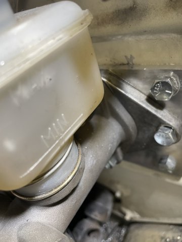

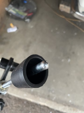

A to Z Posted June 27, 2025 Author Share Posted June 27, 2025 06-26-2025. I finished the manual brake conversion. I had to remove the master again, from the firewall screw in the rod all the way and then take measurements....how far the rod goes into the master cylinder, and then figure out how much rod needed to stick out of the firewall to be just right....and then because it was screwed all the way in, take a bit more off from that and it should be good......but when you change pedal hole height, sometimes you have to shave down the rod to fit in the master without binding from being on a slight angle, etc. So, using the die grinder I got it smaller and decent looking and then re-assembled. Works, pretty good. when I push on the brakes, I can feel it come on within 1-2 inches and by 3 inches the floor it stops, and if I push HARD it completely stops 1.5 to 2 inches from the floor. I set it with about 1/4" of play at the pedal when released. So, we will see how it works on the road. Here are some pics: Quote Link to comment Share on other sites More sharing options...

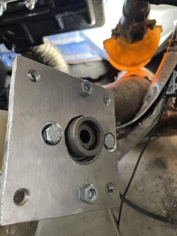

A to Z Posted July 6, 2025 Author Share Posted July 6, 2025 07-05-2025. Installed my Skillard brake master cylinder heat shield. I had to modify it quite extensively for my use. Quote Link to comment Share on other sites More sharing options...
