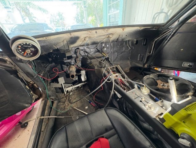

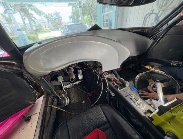

Thanks. I’m excited to start working on the interior. Hopefully I can get this motor in soon, then on to the inside. -
