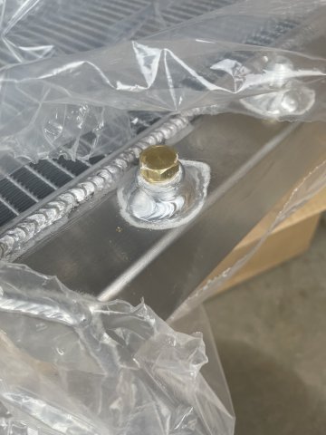

A to Z Posted July 15, 2025 Author Share Posted July 15, 2025 So, the heat issue has caused me to go ahead and order a 3 row aluminum radiator with dual electric fans. I decided to get one I found on Amazon, made by CB Auto - which is in CHINA. So, half price of others and looks to be okay. I also went ahead and got an anode made of zinc that screws into the drain petcock. This is what allows the minerals to attack it instead of the aluminum in the radiator. I also will be switching my thermostat to a 160 degree one I ordered. Since I have had good luck with the chinese parts I have used, we will do this. factory video, click here: https://www.amazon.com/vdp/048db201f503475ea5ee22731531c6e1?product=B0BQGTGGL4&ref=cm_sw_em_r_ib_dt_8D3hq5NBWLJy6 Quote Link to comment Share on other sites More sharing options...

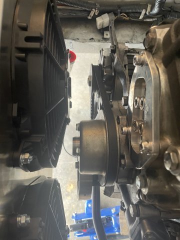

A to Z Posted July 20, 2025 Author Share Posted July 20, 2025 07-19-2025. Well today was a day to get the car ready for it's updated radiator and fans, and do some other small work. I took both SPAL fans and tested them to ensure they work and that they spun in the right direction. Then I began the process of pulling the radiator out. I found that I needed some different bolts for the water pump pulley, and so while there I went ahead and got all new hardware for the radiator when it gets here. I bought some thick rubber washers to isolate the aluminum radiator fromt he car, to keep corrosion of the radiator at bay. After that I swapped out my radiator thermostat from the factory 180 temp to a 160 temp and then installed a new Speedo cable. I spent a little more and got one from the Z car Depot, partly because it comes with a new firewall grommet. Ready for more new parts to arrive! PICS: Quote Link to comment Share on other sites More sharing options...

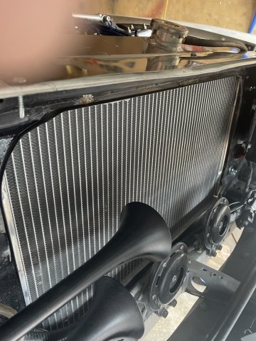

A to Z Posted July 23, 2025 Author Share Posted July 23, 2025 Radiator arrived: Quote Link to comment Share on other sites More sharing options...
A to Z Posted July 23, 2025 Author Share Posted July 23, 2025 Quote Link to comment Share on other sites More sharing options...

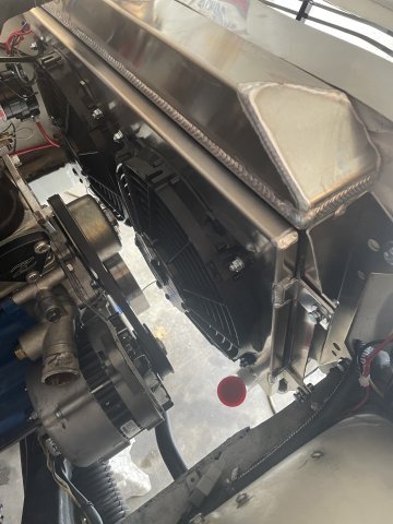

A to Z Posted July 24, 2025 Author Share Posted July 24, 2025 shroud complete and ready to go~! Quote Link to comment Share on other sites More sharing options...

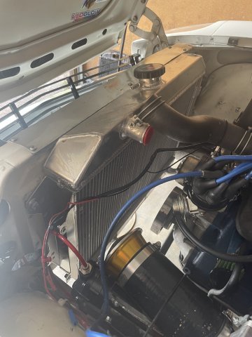

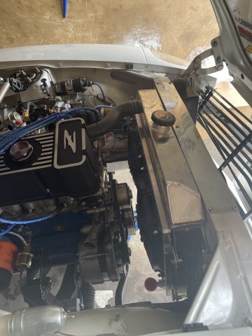

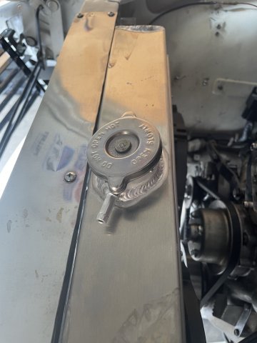

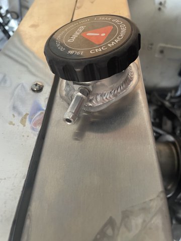

A to Z Posted July 25, 2025 Author Share Posted July 25, 2025 07-25-2025. I had a couple hours today, so I decided to see if the radiator would bolt in. Since June of 2021 I have been building my Z car. This is FIRST aftermarket part EVER to bolt right in. I didn't have to mod it at all. I was speechless. Granted, swapping the fans out to the SPAL fans required drilling and playing with it to get it done. However, I was able to drop the radiator and the fan should assembly right in. It is still loose, but it is there, hoses on, loose, but the idea today was......with a little time to see how far I could get it together, it literally just fell together. So "cubauto" on Amazon, there radiator for our Z cars goes right in! Now, the overflow tube on the cap was put on crooked, so I have to live with that, that is the only negative in an overall very nice looking package. Because of the size of my remaining port on the thermostat housing, using a sensor to turn the fans on and off isn't going to work. Being that my Z is just an around town toy, I will be turning the fans on and off via toggle switch. The remaining switch is 20A rated, but I ordered a switch that externally looks the same but is 30A rated to swap in. I will be feeding both fans with 10 gauge wire which is 30A rated and will forgo using a relay. 30 fA use and it will be basic, clean, and work. I swapped out the 19 lb radiator cap for the facotry 13 lb one for now. Pics follow. Good few hours today! Cheers! 1 Quote Link to comment Share on other sites More sharing options...

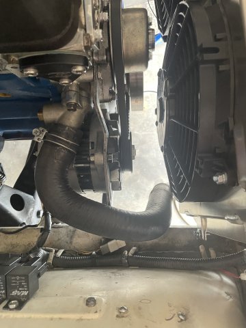

A to Z Posted July 27, 2025 Author Share Posted July 27, 2025 07-26-2025. Okay....radiator and fans installed and working. Waiting on the Thermostat sensor probe that is on it's way. 1 bottle of Water Wetter added. click below for video: fans work.MOV Quote Link to comment Share on other sites More sharing options...
