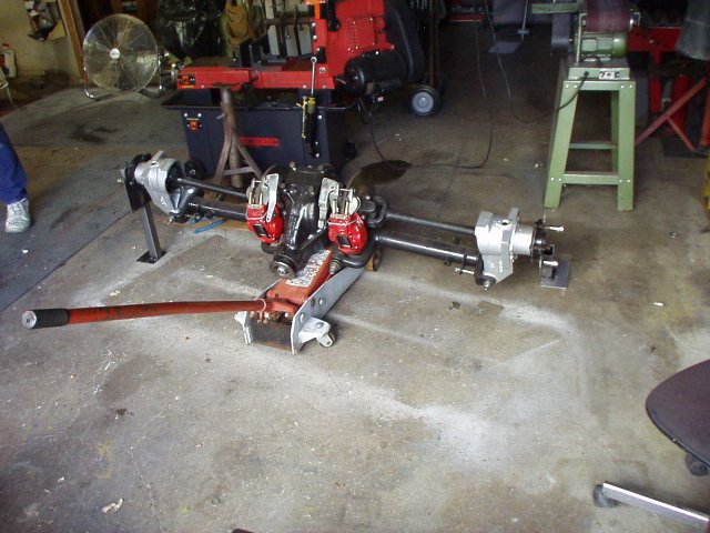

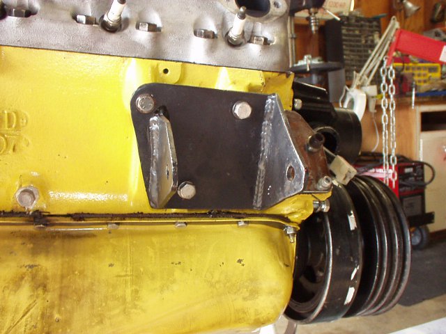

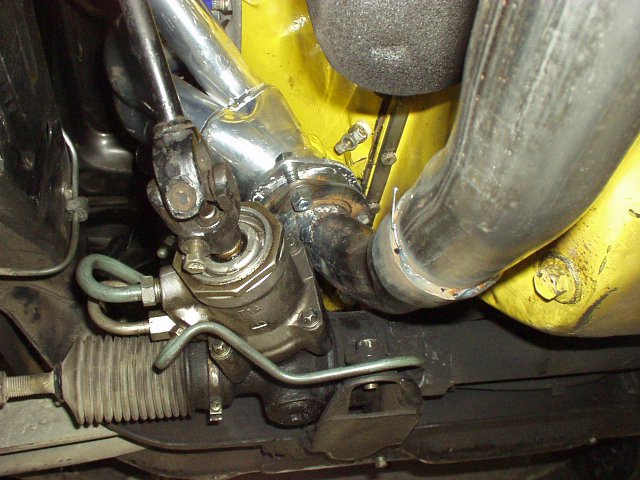

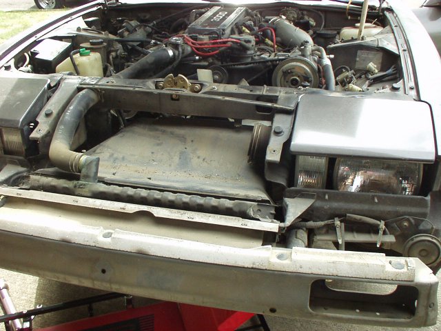

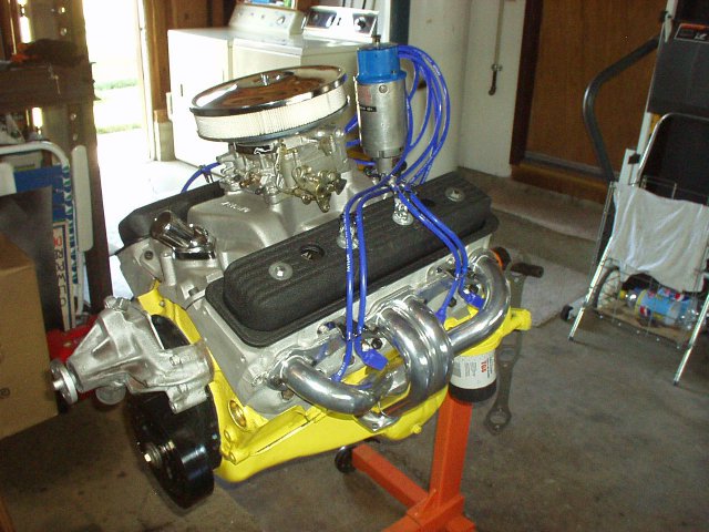

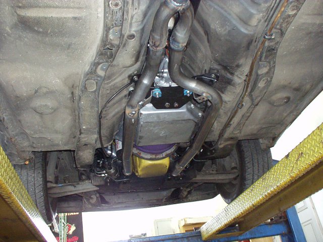

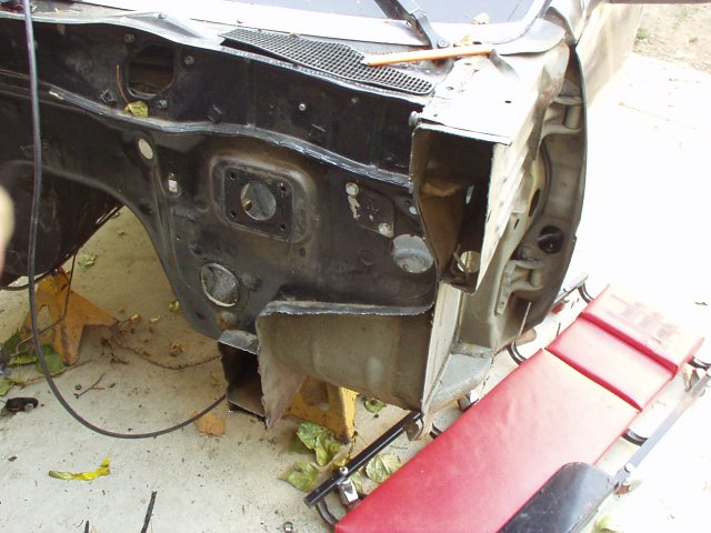

Chaparral2f Posted August 26, 2007 Share Posted August 26, 2007 Here a few pics of my install. I'm changing computers and can't locate the rest of the pics. I am in the process of building a tubular chassis, and will post more as it gets done. 1 The engine 2 The car with the V6 3 This is the only really tight spot between the steering rack and exhaust 4 The mounts I fabbed. (right one shown) 5 Exhaust system 6 Jag rear end (Work still in progress) 7 Detail of firewall after session with the plasma cutter Quote Link to comment Share on other sites More sharing options...
Zerrari GTO Posted August 26, 2007 Share Posted August 26, 2007 Chaparral2f said: Here a few pics of my install. I'm changing computers and can't locate the rest of the pics. I am in the process of building a tubular chassis, and will post more as it gets done.1 The engine 2 The car with the V6 3 This is the only really tight spot between the steering rack and exhaust 4 The mounts I fabbed. (right one shown) 5 Exhaust system 6 Jag rear end (Work still in progress) 7 Detail of firewall after session with the plasma cutter Very cool indeed. Please post more pics when you can; Grumpy is right, this thread may become a revitalized source for Z31/sbc conversions. The Jag IRS is really cool...got to love the inboard discs. Are those stock valve covers with a crinkle finish on them? They look damn good if they are. Quote Link to comment Share on other sites More sharing options...
