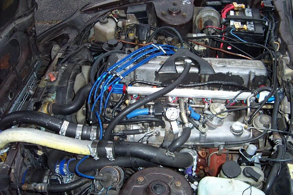

Guest De Schmaydee Posted November 24, 2004 Share Posted November 24, 2004 ...i did mine like this for a while.... (not for everybody)...... ....s Quote Link to comment Share on other sites More sharing options...
Bernardd Posted November 24, 2004 Share Posted November 24, 2004 I've got a z32 maf with a z31 ecu, 440cc injectors. I reprogrammed the ecu and it works great for me. I've got the maf installed in the stock afm location with both intercooler pipes above the maf. It's kinda tight but works. Quote Link to comment Share on other sites More sharing options...
