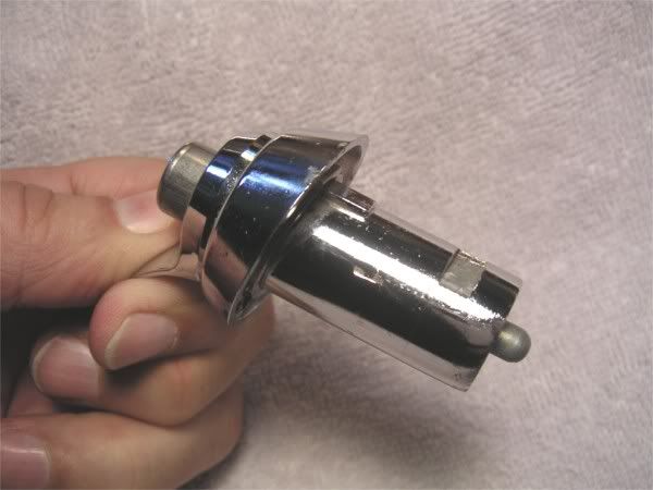

SpeedRacer Posted February 1, 2009 Share Posted February 1, 2009 I posted this before but I think it will help if I post it again. You do not need to use the escutcheons or the rubber gaskets. I picked up some rubber "O" rings at the hardware store and used them behind the lock assembly. I use a Dremel to carefully round out the opening in the fiberglass door panel to accept the lock and "O" ring. I also used a small round file to remove the locator on the lock assembly right up next to the boss so the "O" ring will sit flush with the barrel and boss of the lock. I think that, by using the "O" ring, you will find that it is more complaint and makes it easier to deal with small differences. One last note: I found it very difficult to install the lock retaining clips on the inside of the door. So, I made clips out of piano wire that I got from the hobby shop. This allowed me to simply slide the custom made retaining clips along the barrel of the lock until it fell into the grooves. I hope this helps. Quote Link to comment Share on other sites More sharing options...
ZZZeee Posted February 2, 2009 Share Posted February 2, 2009 It seems we are making progress on refinishing the three sets I have. KEN (I can't remember his HZ screen name) is forwarding pics that I emailed to him to his shop for an estimate... (hopefully) the price is affordable. I'LL have one set as well as KEN and I believe FILMJAY & TOMOHAWK expressed interest as well. I don't know how to be fair to both TOMOHAWK & FILMJAY. BTW, I'm not looking for any profit... just to break even. Total cost including original price and shipped from Canada ($20/set) plus shipping to Ken (~$3/set) plus refinishing (? cost ?) plus return shipping here ($5/set) plus shipping to you (~$5)... something like $50 delivered. Seems a little high but considering the brand new finish and their rarity it's not bad. Keep in mind additional re-keying and new key cost once the set arrives there. Quote Link to comment Share on other sites More sharing options...
ZZZeee Posted February 2, 2009 Share Posted February 2, 2009 SpeedRacer... Thank you for the "O" ring suggestion. That actually looks better than the rubber gaskets and I'll bet it seals just as well. That's a nice clean look!! And this may save some refinishing expense on the escutcheons. UPDATE: The screen name of the guy who may do the button refinishing is Porter. The good news is he hopes to have an estimate in a couple of days. The so-so news is there will only be one set left available. The good news is it'll be at actual cost. Quote Link to comment Share on other sites More sharing options...

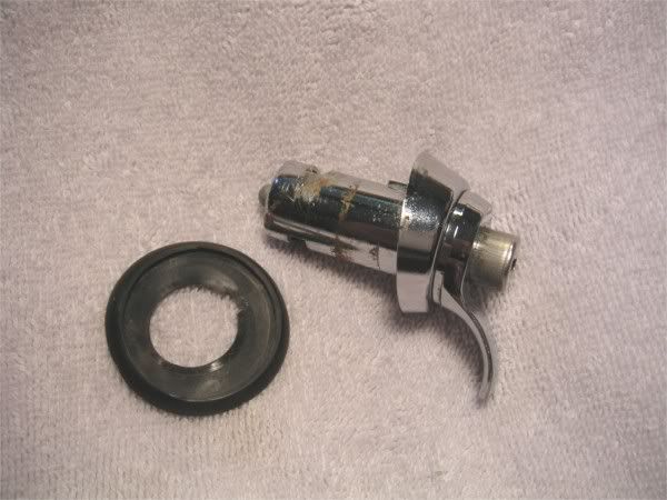

C Pierre Posted June 25, 2011 Share Posted June 25, 2011 Resurrecting this thread to ask for some help. I recently bought a 1975 280Z that was converted with a 250 GTO body and a Chevy 327 V8 in 1992. The driver's door handle backed out of the door about 1/4 inch, but would push back in with no problem ...... until the door latch would no longer work with the outside Honda door pull. Today I opened the door panel and saw the plate that actuated the latch mechanism has slipped over the button from the Honda door pull. How is the door pull locked into the door? This one just seemed to have been pushed in and was relying on friction. There are no clips lying at the bottom of the door and the cylinder end seems to be about flush with the inside of the door making no room for a retaining clip. I hope anyone that has used the Honda door pulls can give me some insight so I don't have to pull the passenger side door apart. The driver's side wasn't pretty and don't ask how long it took for me to figure out how the window crank handle came off - not a standard Datsun part with a clip. Quote Link to comment Share on other sites More sharing options...
Boy from Oz Posted June 25, 2011 Share Posted June 25, 2011 Here is where the Honda clip fit. While I haven't done this work as yet SpeedRacer has indicated in earlier posts how it's done. I suspect the lock goes through the fibreglass skin and the Datsun skin and then a clip is then inserted. Quote Link to comment Share on other sites More sharing options...
C Pierre Posted June 26, 2011 Share Posted June 26, 2011 Here is where the Honda clip fit. Thank you, especially for the picture. It's too bad some of the older pictures from this thread are no longer available. I went ahead and removed the passenger door panel to get a look at the "good" part. No clip that I can see, but it looks like the builder put a set screw on the assembly to hold the part in place. Since I found the window roller (bamper) at the bottom of the driver's door, I can take a day or two to ponder things while I get a new part if they are still available. BTW, I have been watching your build for some time while looking for a car. Now that I have one, I appreciate how you're going about it even more. Quote Link to comment Share on other sites More sharing options...
