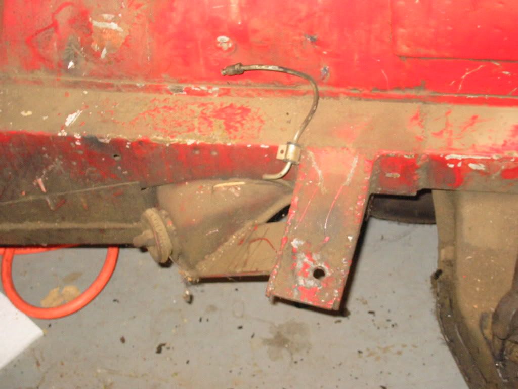

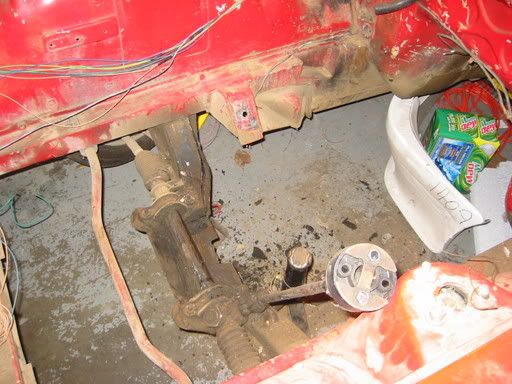

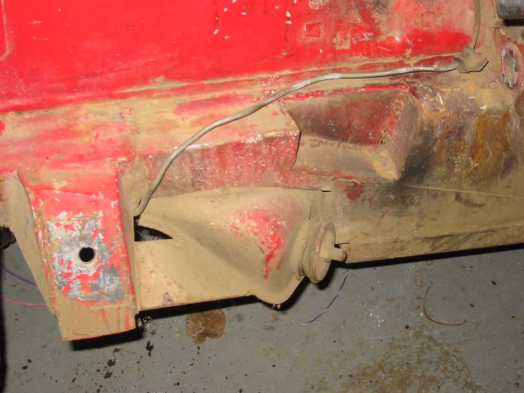

MrBonk Posted January 31, 2005 Share Posted January 31, 2005 Here are some pic's of my mounts and mod cross member.When i have a chance i will roll it out of my garage and steam it off and take better pic's. This is my drivers side mount This is my pass side , as you can see the frame rail had to be reboxed for the shorty headers i wanted to run. My dirty crossmember lol . The center had to be removed and redone to fit the front slump of the 93 5.0. as i said before i will steam it off and get clear pic's mabey this week and replace these. LaterZzz Quote Link to comment Share on other sites More sharing options...
Guest 305240 Posted January 31, 2005 Share Posted January 31, 2005 Nice work on the boxed frame. With my stock exhaust put of the 82 stang it sets real close. I was thinking of taking a short piece of 3" tubing and cut it lengthwise, and box the frame that way. Then after seeing your headers, I hit ebay and am going the route you've taken. Thanks for the idea. Those engine mounts look good also. What brand of remote filter adapter are you going to run? Or, are you going to need one with the mounts relocated like that? Keep up the good work! Quote Link to comment Share on other sites More sharing options...
MrBonk Posted January 31, 2005 Author Share Posted January 31, 2005 thats what that the frame was boxed for was the 82 5.0 when i had that eng in there but works well with the newer 86-93 shortys.As for the filter it needs no movment fits very well on the eng . Quote Link to comment Share on other sites More sharing options...
Guest 305240 Posted February 1, 2005 Share Posted February 1, 2005 Interesting and intreging. I've got mine bolted in where I want it using stock mounts and 81 Granada engine mounts. I have room enough to remove the C4 without pulling the engine. I have a plate of sorts with a riser bolted from the engine mounting plate to the rubber Z mounts. Everything fits great. No steering shaft cutting, no frame cutting, I can bolt up to the stock 72 tranny mount. I still believe my weakest link is the mounting system. Now, If I was to install the headers one side at a time, remove the mounting plate I have and fab up underslung type mounts (simular to what you have), remove the Z mounts altogether, I'm thinking I wouldn't have to do anything with the steering shaft. That, and it would look a lot better in my opinion. Man, I love this club. Quote Link to comment Share on other sites More sharing options...

Guest 305240 Posted March 5, 2005 Share Posted March 5, 2005 You were right on the header tip. I just bolted mine in. I was surprised at the clearence by the steering shaft. I could get the passengers side exhaust pipe fabbed up, but man would it be tight. I'll go ahead and box the frame rail with the tubing idea I have. The more I work on this and the more I read on this forum, the easier this swap is getting. Thanks again. Quote Link to comment Share on other sites More sharing options...
