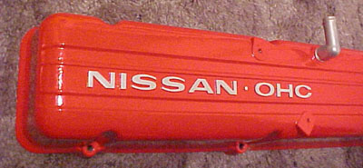

Tony240ZT Posted January 31, 2006 Share Posted January 31, 2006 I've done it, and then shot it clear coat. Looked nice for a while.. Doesn't hold up well to chemicals such as oil and engine cleaners. That was about 4 years ago. Looks pretty much the same now, just more dull. Powder coat the cover if you want a gloss like color finish. Here are some that I've had powder coated in the past: I still have 3 Turbo covers out in the garage I've been meaning to clean up and get coated. Quote Link to comment Share on other sites More sharing options...
